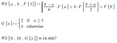

function doesnt work if in argument function there is if
is it possible to add function as argument to another function if in that function is if statement?

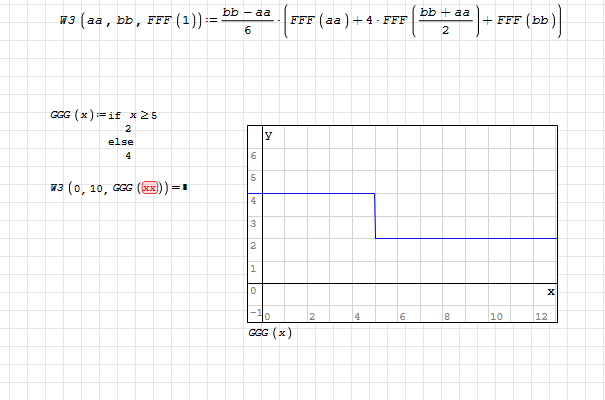

no i tried with out any units.. as far as i can tell its if there is if in the function i cant use it as argument for another function even if it plots perfect as i imagine..111fff.PNG
so i played around even further:
it seems that: i can make boolean operations with x and i can use if if x is not evaluated.. but if in if statement there is x then it shows that x is not defined.? is this bug?
#4 Posted: 9/27/2020 7:46:38 PM
1,139 likes in 1,805 posts.
This is an "if-issue". It can't be integrate, nor derivate (sometimes) and also can't be called in this way. As workaround use cases.
