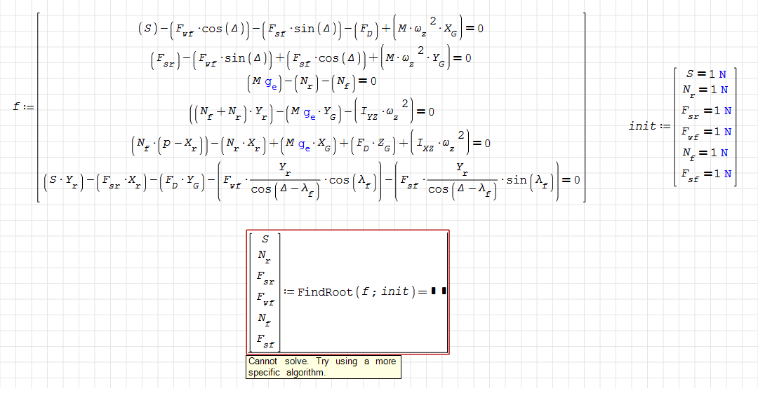

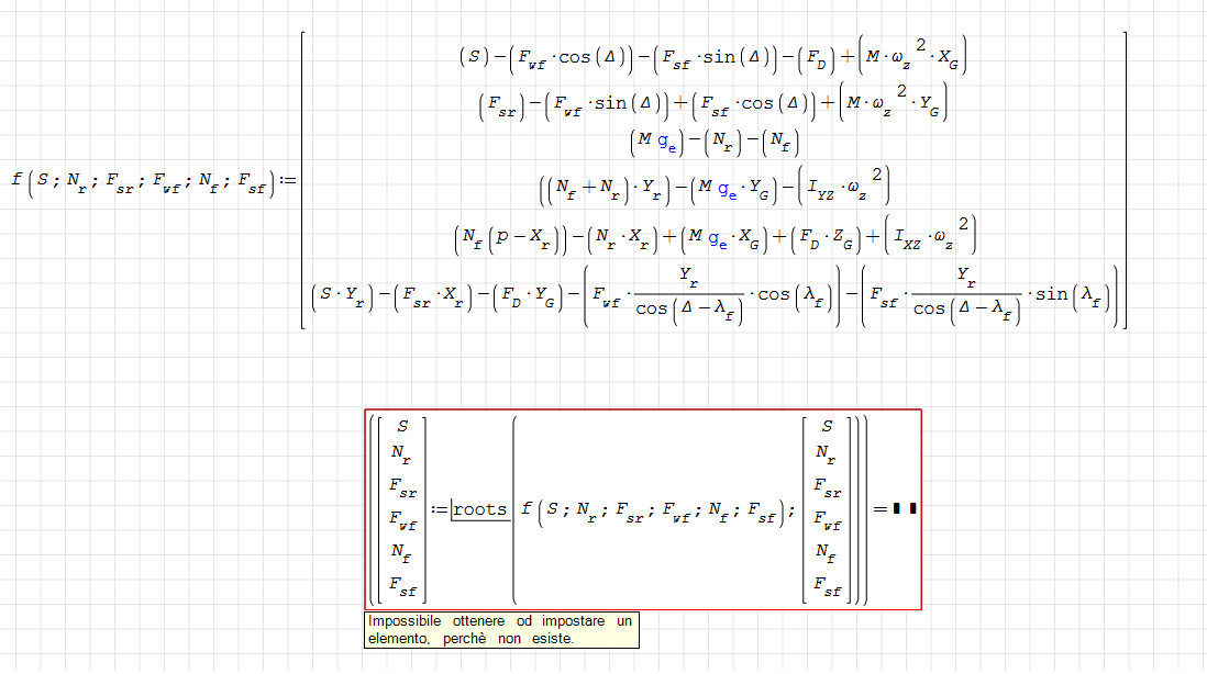

Hi to everyone
I am having difficulty solving a linear system like in the picture.
the error says:"impossible to get or set an item because it does not exist"
does anyone know where the error can be and how to solve this problem?
Thanks in advance
#2 Posted: 11/5/2019 3:08:12 PM
127 likes in 342 posts.
"roots" does not work with the units. You must adimensionare equations, or you can try the other features present in the plugin (eg "FindRoot" present "Nonlinear solvers" plugin)

I tried another function but it still gives me an error...
#4 Posted: 11/5/2019 11:57:28 PM
It's a huge system, and generally does not accept all initials same.
I would zap units first. This kind of solving should have it be
solved from P & P [Pain & Prestige] as it reflects real project
that does come out of the blue. Even Mathcad Given/Find may fail
or pedal through constrain.
Attach the work sheet ... some source reference as well.

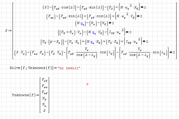

#6 Posted: 11/6/2019 4:16:32 AM
1,361 likes in 2,275 posts.
Equations 3 and 4 probably demand different values for N.r+N.f So there is no solution.
If the system has a solution, the function Solve() from Maxima plugin might find it.

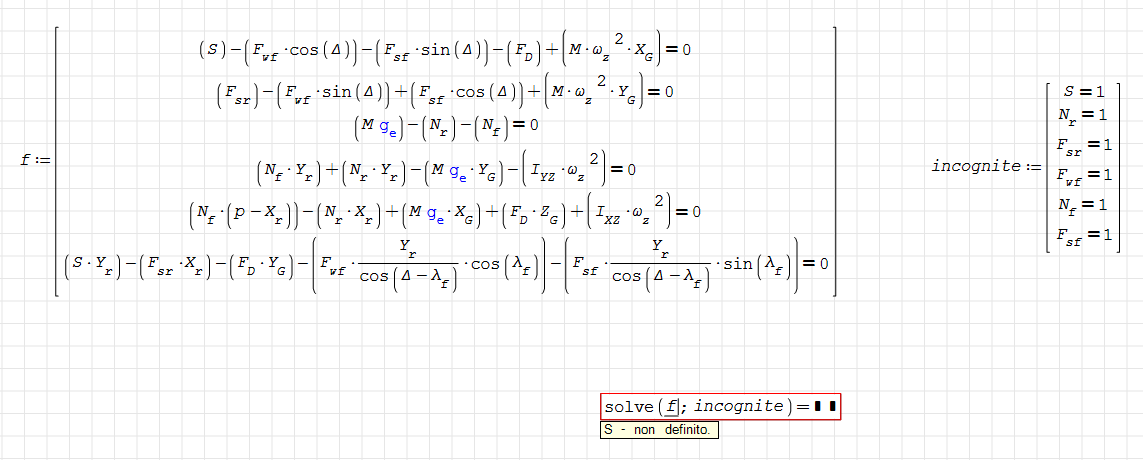

I tried to use the solve function but it still gives me an error saying that S is not defined
#9 Posted: 11/6/2019 3:47:31 PM
Did you read my reply just before your visit ?
sorry, when I wrote, I didn't notice your message
