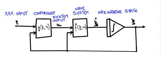

A general purpose, simple ODE solver function that uses Euler integration to simulate (possibly non-linear) multi-inputs dynamic systems, with "embedded" provision for state feedback controller.
In its most general form, the function implements a system of the form:
where dot notation indicates time derivative.
A few examples are provided.

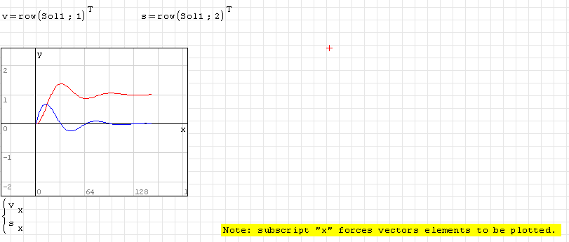

#3 Posted: 10/6/2013 2:56:00 AM
It is an (undocumented?) feature I discovered by chance.
Notice the "staircased" behaviour.
The X-Y plot plug-in has a similar property: in that case it seems that ANY variable name, not just "x", can be used as a subscript to obtain vector plot.
Radovan Omorjan 10/6/2013 8:03:00 AM
#4 Posted: 10/6/2013 10:28:59 AM
WroteIt is an (undocumented?) feature.
Not undocumented any more. SVN Activebook updated.
