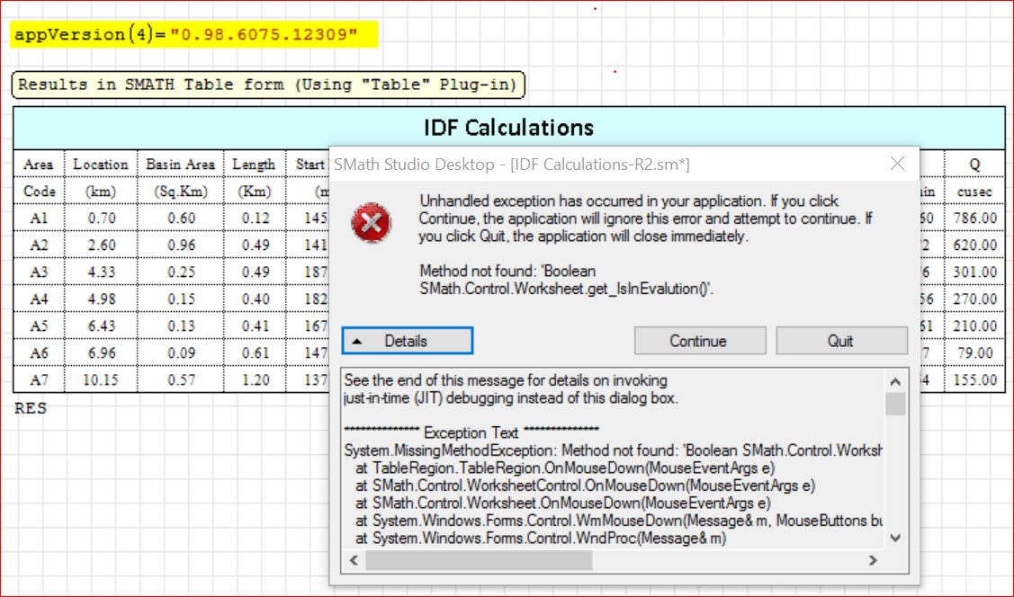

In SS 98.6075, the attached error message appears when left-clicked on a Table.

Confirmed, this affects several plug-ins (modeller, combobox, ...). We'll fix them ASAP.

Sorry to trouble you. The problem with TableRegion is still there. Today's update for SnapshotRegion did not help.
There is no update for TableRegion.
I don't know if I am missing some thing.

Fix in SMath Studio. Please wait for a new nightly byild (hope, today).
