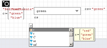

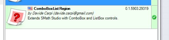

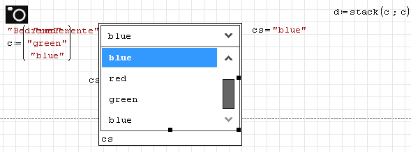

As stated in this post, I do not experience the problems reported SMath 0.97.5329 download topic. The attached files all run without problems and I can access all controls without crash.
Plugin Slider Region.sm (15.26 KiB) downloaded 1904 time(s).

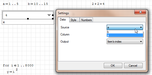

I mean changing the value of the "Source" parameter in the form

In the other hand, like Ioan, I have noticed issues on evaluations (trigggered twice, not triggered, triggered correctly...) both on the desktop and the portable distributions.
screencasts: evaluation triggered twice , evaluation not triggered
I have Win 7 x64 (home premium) and your same framework (2.0.50727.5477) but the behaviors is not the same (both on the desktop and the portable distributions).
ioan92 8/6/2014 8:01:00 AM

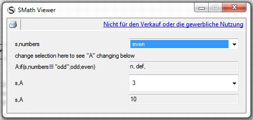

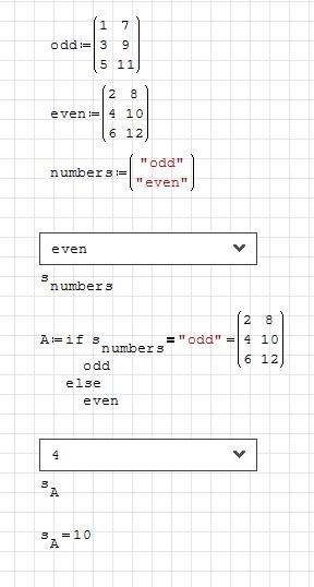

as I've been using your very util plugin during
my tesis for the calculation of wooden joints,
I found out about a problem concerning the combined
use along with the Viewer.
It seems to me the once the Viewer loaded the file, all
the settings about the input variables for the comboboxList
are made. In the case, like you see in the example-pictures,
of multiple lists depending on their selection to decide
about the next-ones input, it comes to dificulties concerning
the update process.
The problem still consists with the newest version of SMath.
Is there a way to fix this problem?
I'd be glad aboud any advice of solution!
Thanks a lot!
Greetings,
Eckhard Bräuchler
#20 Posted: 3/9/2016 7:57:22 AM
1,443 likes in 2,936 posts.
Confirmed, I'll provide a fix ASAP.
