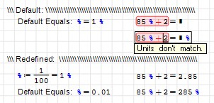

To the best of my knowledge, you should be able to redefine the 「%」 from 「dimensionless」 to a 「number」 of value: 0.01; keypress the following at the top of your worksheet:
'%:1/100
(NOTE: I currently have the settings.inf file modified to Imperial units 「OutputUnitsSystem=Imperial」 and % appears to behave as expected when it is redefined to 0.01)
