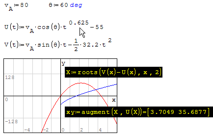

Good afternoon everyone.
I'm using the "roots" command, but I'm not getting the two points where the line intersects the parabola. The command gives me only one result and omits the other point. Attached is the file and image of the problem. How can I find both intersection points?

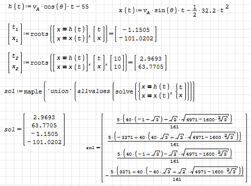

Hi Sergio. There are a 3 argument version of roots, where the third is a guess value for the root.

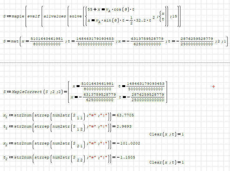

Here your solution solved with maple plugin.
No need to enter guess points for this.
Maxima can solve it too, similarly.
PS: MapleCorrect() function can be found here.
Assign() function can be used instead of str2num() + num2str() + strrep().

Hi. This is another way.

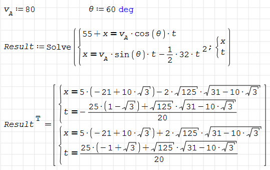

I found a Windows laptop.
And tried Maxima plugin Solve().
It can solve easily.
