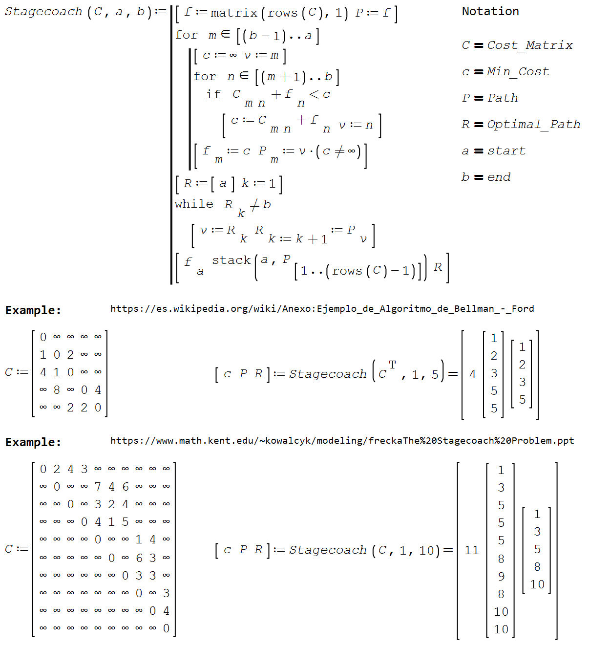

#4 Posted: 9/24/2026 2:28:21 AM
1,139 likes in 1,805 posts.
Hi. You can start with this.
Stagecoach Problem.sm (19.57 KiB) downloaded 286 time(s).
