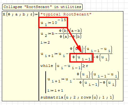

there's no mystic, Gamma() in SMath Studio is an approximated function, defined for not-null positive values. In your X(4) you have to initialize u[1] with a small value to not hurt the first iteration in the loop.
![2017-06-12 18_21_29-SMath Studio - [Maths%20Gamma(x)%20Unsolvable.sm_].png](/en-US/files/Download/exVChH/2017-06-12-18_21_29-SMath-Studio---[Maths%20Gamma(x)%20Unsolvable.sm_].png)

#3 Posted: 6/12/2017 1:47:03 PM
Thanks Davide, solves well now !
