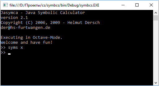

#6 Posted: 2/5/2019 10:18:47 PM
1,555 likes in 1,867 posts.
Updated ( github ).
The project can be compiled, but still does not work as expected.

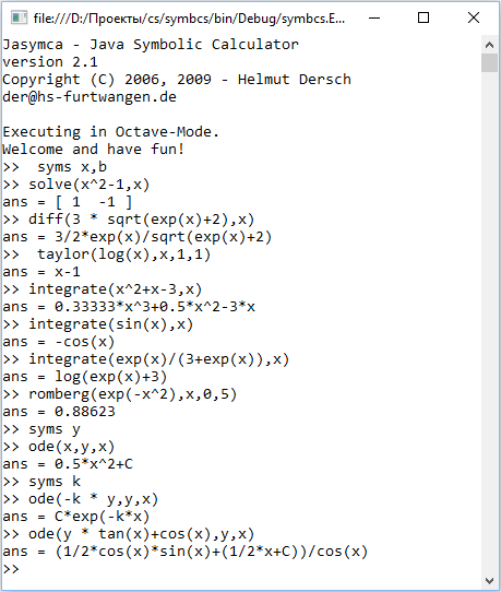

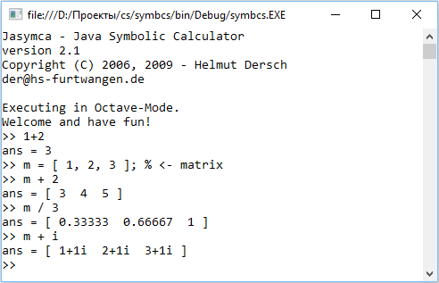

#7 Posted: 2/8/2019 11:14:39 AM
Simple calculations now work.
Alvaro 2/8/2019 3:18:00 PM
#8 Posted: 2/8/2019 7:05:16 PM
More functions.
Andrey Ivashov 11/9/2020 8:31:00 PM
