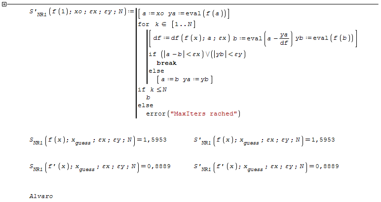

Hi. I can't call a function which uses a call for functions too. How to solve that? Example in the attached.
function_1v.sm (17.56 KiB) downloaded 1346 time(s).

I guess f(a) isn't recognized as a function in the call df(f(a)...) as f(a) evaluates to a number, not a function. Use df(f(x)... instead, with x being something undefined.

Hi Martin. You're right! Thanks.
