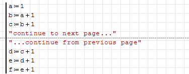

Is there a way to get an equation to fit onto an A4 page when the equation line length is longer than the page width please?
I know MathCAD can do this with control enter.
I have scoured the forums and googled this but not found an answer yet.
Thanks
#17 Posted: 3/6/2014 10:29:18 AM
1,443 likes in 2,936 posts.
AFAIK, there's no way... you can adjust the formatting using something like in the picture attached
