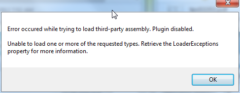

SMath Forum SMath Studio Bugs & Problems Export to Excel does not work 1 Pages (3 items) Export to Excel does not work - ExcelCollab.dll Plug-in error in Windows 7 Smath 0.95.4594 - Messages Go to last post #1 Posted: 7/31/2012 10:57:19 AM Rob 0 likes in 8 posts. Group: User Hi,I placed ExcelCollab.dll in C:\Program Files\SMath\SMath Studio\plugins and received the following error:Error occurred while trying to load third-party assembly. exportcell was not available.I am using Version 0.95.4594 on Windows 7. Would you assist.Rob #2 Posted: 7/31/2012 4:44:42 PM Andrey Ivashov 2,344 likes in 4,057 posts. Group: Super Administrator I've recompiled plugin. Please try it. ExcelCollab.zip (51.26 KiB) downloaded 510 time(s). #3 Posted: 8/1/2012 2:57:34 PM Rob 0 likes in 8 posts. Group: User Thank you for promptly looking into this issue.The re-compiled file was read into Smath! And I see the commands importCell and exportCell!I am trying to reproduce the examples in the Collaboration with Excel post but need more time.Rob 1 Pages (3 items) New Posts No New Posts
