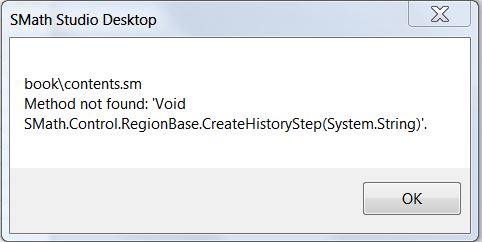

Where is it? I clicked on "Help" ..Reference Book and got an error message, which says Method not found. the forum software won't let me upload an image from my computer or I could show you a screenshot of the dialog box. Why wasn't the Reference Book included in the software I downloaded?

Extensions (those downloaded via Extensions Manager) are stored in your %APPDATA%\SMath\Extensions directory
About the error, what version of SMath Studio are you using? I suggest you to use the latest Nightly build

Please, try to set default Reference Book in the Extension Manager as shown below:
