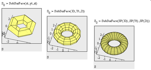

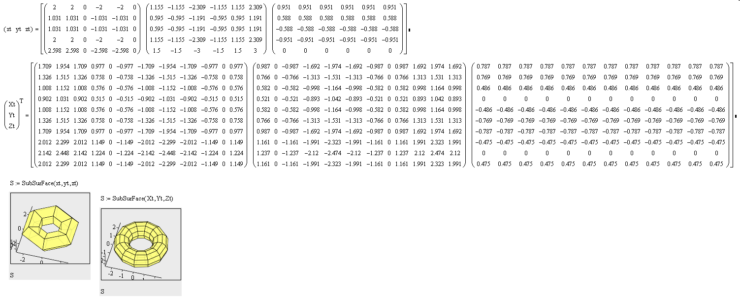

#2 Posted: 10/10/2017 8:23:38 AM
Presumably, I understand what you are after ...
... Create a 3D system of vertices, you need 3 matrices.
We have it in Mathcad from Russia. Even if it is possible
to code in Smath, no way to plot because Smath does not plot
stacked matrices [it does not plot matrices at all].
Smath plots matrices as image but not as 3D.
The Mathcad 11 program subdivides by 2 each step from
the Catmul-Clark B_Spline. On the other hand, Mathcad
is on ORIGIN [0], it adds difficulty to code Smath.
In short: I can attempt to code wrt Smath ORIGIN [1].
If your base 3D system does not plot 3 stacked matrices... zap !
Chers, Jean

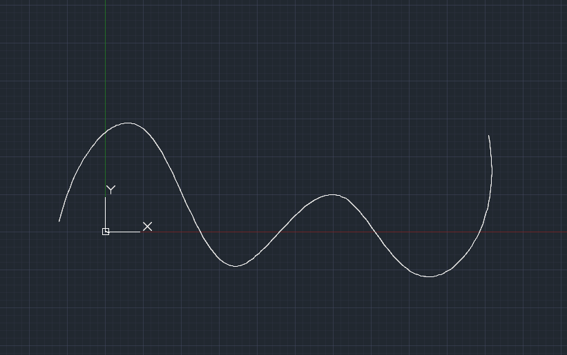

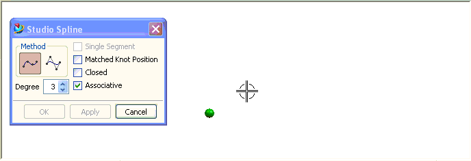

#4 Posted: 10/10/2017 7:17:49 PM
Hello!
I have poorly explained and you misunderstood me. Our spline is NURBS. https://en.wikipedia.org/wiki/Non-uniform_rational_B-spline . We are interested only in the spline line which consists of 3 coordinates.
There are points that lie on the line, I call them user points
There are points that lie outside the line, I call them reference points
In your example, you point the reference points to draw a spline.
Below I bring an animated gif, so you understand what I'm talking about.
We would like to understand how from points lying on the line, get points outside the line, and vice versa.
It is not yet clear how to get an Knot value and a degree of the spline curve for constructing a spline. At the moment the program uses that knot value and the degree that we read from a file created in another CAD
Here, also shows the construction of the spline, and there is a switch between points lying on the line and points outside the line. Pay attention to the degree that is being changed. https://en.wikipedia.org/wiki/File:Spline01.gif
Sorry for the incorrect mathematical terminology!

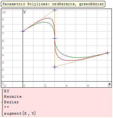

#6 Posted: 10/11/2017 5:39:53 PM
I looked at the example of Hermite's polyline, the resulting spline is not similar to the spline obtained in the CAD system. I send the superimposed spline of the CAD system to the graph of the Hermite polyline.
Bézier Cubic 4 cntrl points looks more like the desired spline.
Spline used in CAD systems non-uniform rational B-spline (NURBS).
I spread an animated gif from Wikipedia, it will explain very well how the spline is drawn in the CAD system and how it is edited.
#7 Posted: 10/11/2017 10:46:14 PM
.WroteI looked at the example of Hermite's polyline, the resulting spline is not similar to the spline obtained in the CAD system. I send the superimposed spline of the CAD system to the graph of the Hermite polyline.
The CAD example [image] is probably Bézier parametric.
They just perform differently, especially if the end
points aren't duplicated. In other applications,
Hermite has much better smoothing properties than
DeBoor, Bézier .
Spline Hermite Polyline.sm (39.13 KiB) downloaded 1198 time(s).

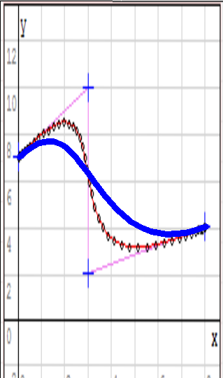

As part of our program, we can add many kinds of spline lines, but we need a spline that supports all the other KADs.
I studied the spline lines sent by you. below the picture. I also added the information that AutoCAD adds to the file for the correct display of the spline line description
black dashed line - this is because the points outside the spline line are located
pink - this is the spline line obtained by auto cadence
File not found.File not found.File not found.File not found.File not found.

... from what your system shows, I guess the spline is Bézier polyline.
This type of multipoint is executed from the DeCasteljau algorithm,
more numerically stable. We can't reproduce it scalar algo style Mathcad 8.
I may still have the Bézier polyline demo in what's left from Mathcad 11.
Will be back later on.
Cheers, Jean
#14 Posted: 10/16/2017 10:27:27 AM
... that confirms your CAD system is Bézier-DeCasteljau.
Spline Polyline Hermite_Bezier.sm (49.36 KiB) downloaded 1262 time(s).
