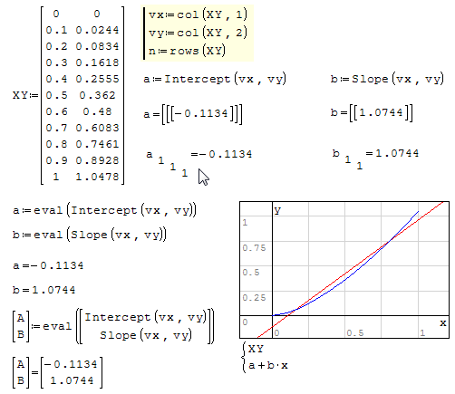

Can't explain to myself double/triple nesting [6179 Win 7].
Bugs SlopeIntercept.sm (10.34 KiB) downloaded 1331 time(s).

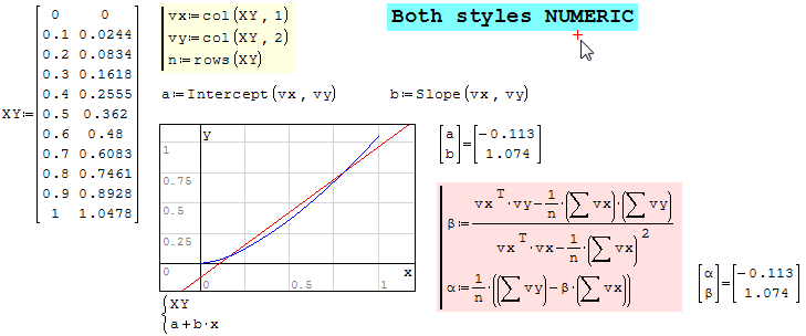

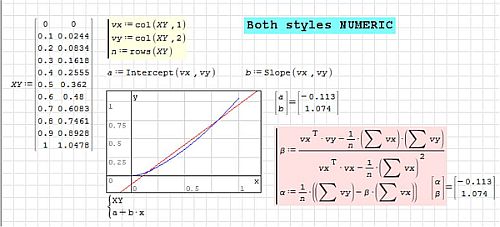

Hello Jean,
something to check in the symbolic engine; change the optimization of a:Intercept(vx,vy) from symbolic to numeric
frapuano 12/7/2017 2:40:00 PM
#3 Posted: 12/7/2017 2:03:58 PM
Thanks Davide ... works fine Numeric !

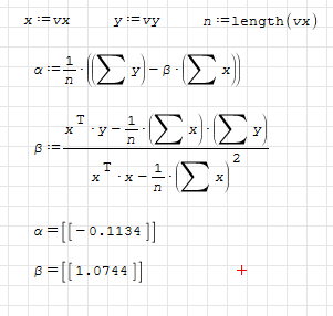

#5 Posted: 1/15/2018 2:10:50 PM
Fixed. Will be available with a next nightly build.
Was just a matter of RIGHTdoing.
Thanks Andrey to keep me addict to Smath !

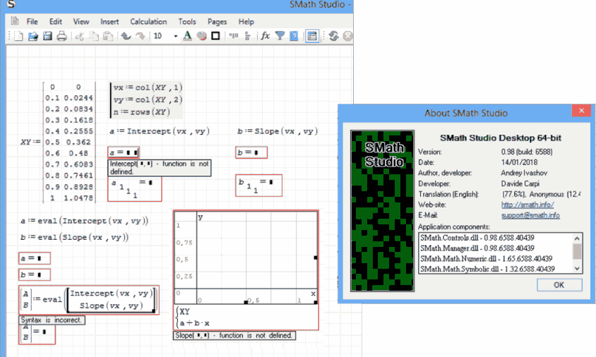

I get these errors when I run the file:
Carlos

Thanks Jean, but I get the same error.
Is your Smath studio 32-bit?
My Smath Studio 64-bit, does not recognize the
functions of Interception and slope.
Carlos

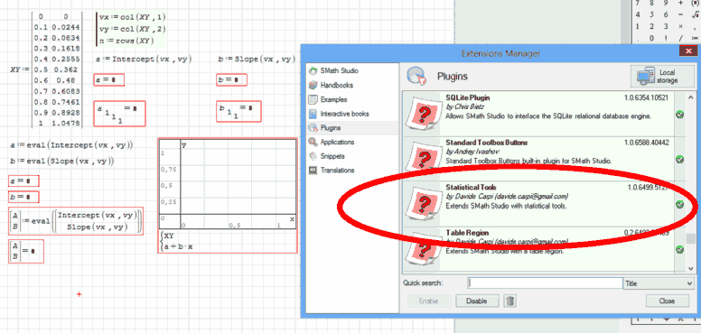

The Functions are in Statistical Tools Plugin.
Carlos, do you have statistical tools plug-in installed and enabled?

Quote
Yes I have it.
Carlos
