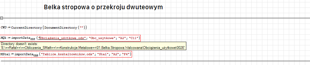

After upgrading from version (7610) to version (7808), a Data Exchange add-on error appeared in my calculation sheets. The message "Directory doesn't exist" started appearing. I have no idea why this is happening.Data_Exchange_error.png
In previous versions of SMath everything worked fine.

Thank you, it's related to characters encoding; it affects other functionalities of the plugin too, I'll fix ASAP
