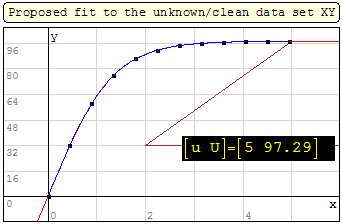

#1 Posted: 5/18/2022 11:06:02 AM
In all humility, this fitting session toke me hours.
However so much rewarding for the Client.
Simple observation about Auto-calculation mode.
As the fit started being productive @ M ~ 150 auto-calc was operative.
As the fit was getting better by increasing M auto-calc didn't work anymore.
... simple: F9 ... Finally, superb for publishing.
Cheers ... Jean.
Genfit Ligand.sm (70.9 KiB) downloaded 1554 time(s).
#2 Posted: 5/24/2022 8:32:15 AM
... @ this point, publish your project clean well decimated.
Genfit TREASURY Ligand Export_Publish Copy.sm (59.5 KiB) downloaded 1497 time(s).
