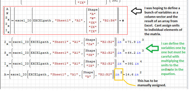

#7 Posted: 11/13/2015 9:02:37 PM
So this is proving to be more challenging than I imagined.
I think I can do what I want with some judicious trimming and logic. But I need a little help...
1. Symbolic optimization for importing data from spreadsheets: Does this matter if some of the entries in the cells are text entries?
2. Finding the right row is a challenge. the vlookup function would be what I would use in Excel to find the right row. Once I can get to the right row, I can extract the column that I need.
My challenge is getting to the right row in an efficient manner. Once I can get to the row, I can make the definitions that I need.
Thing is how do we 'find' the row efficiently?
Dennis

#16 Posted: 12/4/2015 1:56:53 PM
Ryan-
I am curious as to why you are taking the approach of vlookup? you will need to know the column for the info that you require- a bit risky because if you are off or something changes, the reference you are relying on can change.
Alex- I will update my plugin and try your suggestions.
Can you think of a way to do column vectors with ordinates and units? For example I want to define the following variables as a column vector in SMath, then pass to Excel, do some work then bring the resulting values back to SMAth to do more work. It would be advantageous to be able to have units built in.
For example the 6 row vector defining variables for shape size, area, weight, and 3 physical properties.
Shape
A
W
Sx
Zx
Ix
Pass that 1x6 array to Excel.
Excel then uses the first argument to find values for A, W, Sx, Zx, and Ix.
Return 1x5 that to SMath. As a single operation it works.
But when I try to use it to define variables, then it gives me a syntax error.
File not found.File not found.File not found.

#17 Posted: 12/4/2015 4:04:06 PM
WroteFor example I want to define the following variables as a column vector in SMath, then pass to Excel.
The calcbook you attached actually does do it. The issue here is that you are trying a "nested" definition of variables. You can assign the output from EXCEL to a single matrix "A" but you cannot assign very same output to a matrix of undefined variables.
What you can do is to use function el(), say variable:=el(A,1)
WroteIt would be advantageous to be able to have units built in.
Please elaborate what do you mean here - will do my best to help.
Also it would be helpful if you would attache EXCEL files to the post that do not require special .dll files to run.
Also if you are interested, there is a better way to display excel screenshots in your calcs (usin my plugin excel_PNGv2)

Alex-
You replied as I was editing.
I though that we could define a group of variables as a column vector. Now that I try it I see that it does not work...
That is the last bit of the worksheet that I posted.
EDIT: i am still trying to figure out the PNG function of the plugin.
custom .dll- yes it is a custom dll that i am trying to utilize. its a search function and database provided by the material code governing body with their data. its free and redistributable.
i was trying to figure out how to use the dll directly with SMath but the responses above tell me its above my ability with programming, so I am stuck with making Excel do my heavy lifting.
for years working with excel we had to rely on tedious row/column lookups. a very clever fellow wrote a foxpro database and search function and wrapped it into a dll so that we can call it as
That is how Ryan is doing the data lookup in his spreadsheets. It works, but it is challenging and tedious and can be easily broken with typos.
Once the dll is installed, then by enabling the VBA macro one can simply call the functions like this within excel-
=AISC(Shape,Prop)
to get the right information.
That is what I am trying to do in my excel spreadsheet. Its not the most elegant way, but much cleaner than big datatables and spreadsheet lookups.

#20 Posted: 12/4/2015 5:50:42 PM
Little late with my reply, but here how you can use PNG in your calcs if you choose to (see attached).
Also you can include the units if they are defined properly in excel file (update plugin). See attached.
