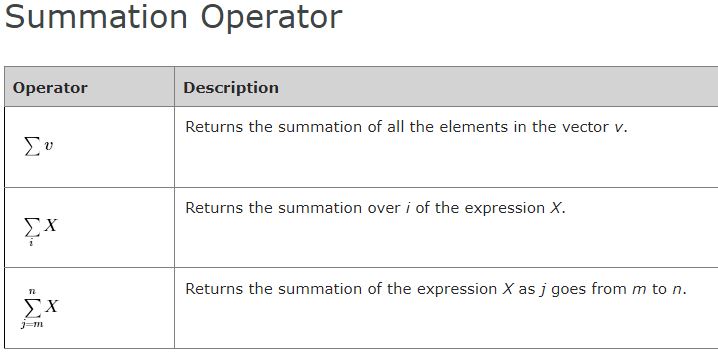

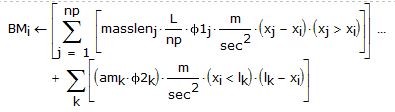

I am trying to convert a Mathcad 15 sheet, and have a problem with the below equation:
Is there a summation within Smath that will do the second summation?
From the Mathcad help:
Thanks in advance
Ian

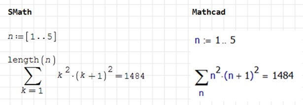

#2 Posted: 12/9/2021 12:33:55 PM
1,134 likes in 1,805 posts.
Hi. There are not equivalent, but this is how to convert it into usual summation operator.

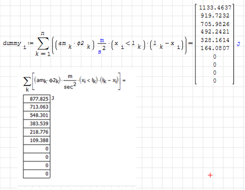

Hi. As Viacheslav says, it's better in this case the mathcad file. Just a couple of notes.
You use a for loop with i as counter. Thus, at the exit, i equals the last count value, not the entire range. So, or you redefine i as range, or use this way for not changing i value
Actually, SMath doesn't have "range" variables, it only have scalars and matrices. But mathcad have "true" range variables, which it's more a complication than an adventage. BTW in SMath you can't use a range variable in the same way, and sometimes needs some dummy variable for detect them
Finally, remember that in mathcad sqrt(-1) is 1i, but in SMath it is just i, so using is as counter you loose all the complex algebra.
Bests regards.

Jean, I am at a loss as to which part of your file I should be looking at.
It just shows how to run summation wrt several dependent functions.

The A,B are numerical two vectors of coefficients.
Then introduced in the scalar function wrt sin/cos.
#12 Posted: 12/10/2021 3:00:17 PM
1,555 likes in 1,867 posts.
I think that there should be such a replacement.
