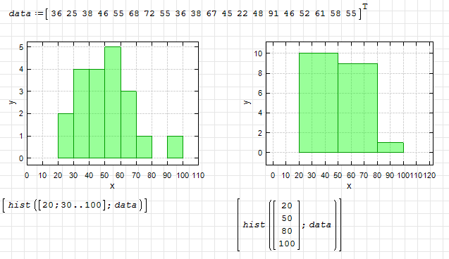

routine for X-Y plot
hist.sm (14.89 KiB) downloaded 1248 time(s).
frapuano 1/12/2019 8:33:00 AM

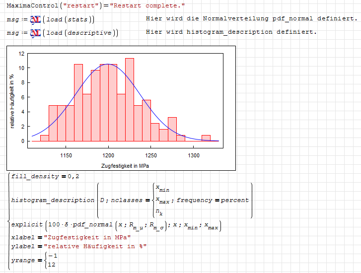

See Maxima docs for available functions and options
Streuung.sm (45.46 KiB) downloaded 1258 time(s).
streug.rar (291 B) downloaded 353 time(s).
frapuano 1/13/2019 5:20:00 AM

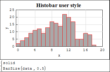

This demo to illustrate the CLT
From native Smath, you can have:
1. colors at will [rich from X_Y plot], even white to imitate no bar.
2. Slightly separated, joined, slightly overlapped.
3. solid or hatched at will.
Stat Histogram BarColor.sm (26.33 KiB) downloaded 1227 time(s).

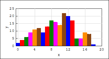

#10 Posted: 1/14/2019 12:48:22 AM
... or like this.
