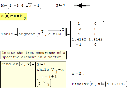

#3 Posted: 5/27/2020 9:03:55 PM
1,443 likes in 2,936 posts.
Also
(move the equal in the booleans from the leftmost addendum to the rightmost if you don't want to match zeros from the original vector as positive values)
frapuano 5/28/2020 5:09:00 AM
#4 Posted: 5/27/2020 9:56:07 PM
Truth table in more general, multi purpose.
Utilities Matrix Truth Table [Locate row_col].sm (43.62 KiB) downloaded 1001 time(s).

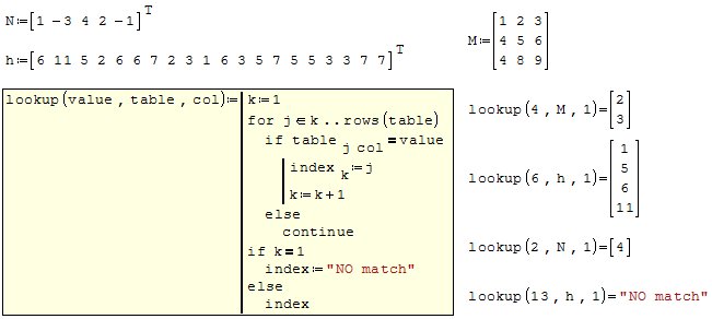

#5 Posted: 5/28/2020 1:53:56 AM
1,134 likes in 1,805 posts.
Hi. Another couple of solutions.
problem.sm (13.97 KiB) downloaded 1173 time(s).
