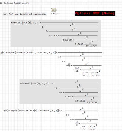

This is an algorithm that converts some functions to continuous fractions.
The result is compared with that obtained by the CONFRAC function of MAPLE.
Commentary:
For the ASIN, ACOS and ATAN functions, applying the CONFRAC function of MAPLE
in SmathStudio 7666 gives the result of "Empty stack"

#2 Posted: 1/2/2021 11:18:45 AM
Thanks Carlos for the 6179, saved, works fine, slow in my laptop.
Maybe Viacheslav will doctor maple 7666.
Thiele continued fraction is pure fascination, simply !
Your module [K, Table] is my companion, doing so well.
The reduction to J_frac is manual only, but simple.
After all, maths is work ... associative work.
Take care Carlos ... Jean
