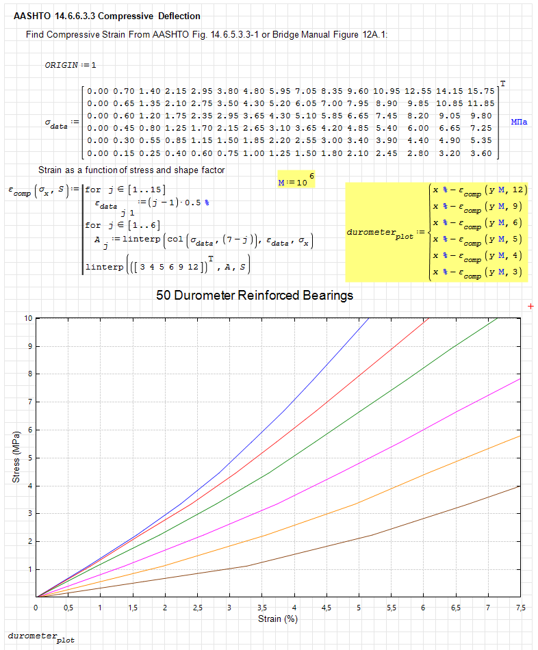

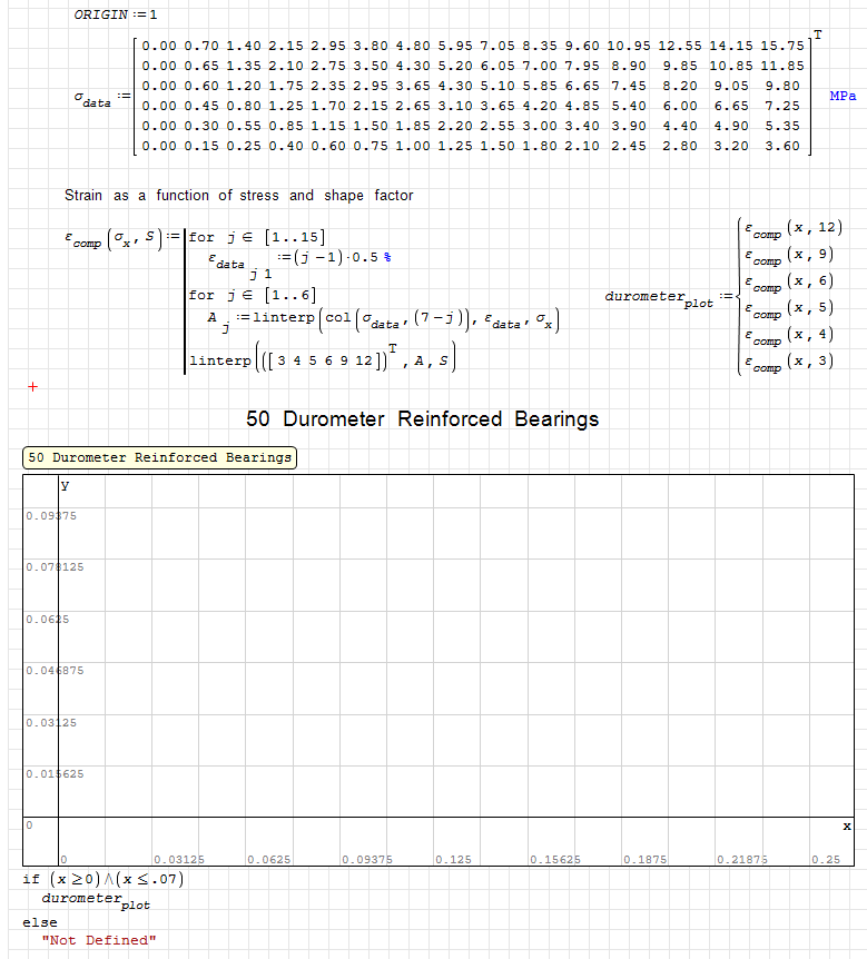

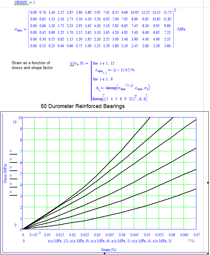

Hello again,
Question: Below is a screenshot of a 2D plot I can pull off in Mathcad. Does Smath studio have the ability to do similar? I was looking in the wiki and other examples, it seems as if they might be an option, but I can't find anything for defining X-Y plot limits. I think I can pull off the multiple lines with the System of Values smath command, and get each of those durometer lines at 12, 9, 6, 5, 4, and 3. But I am struggling with getting it to plot anything at all.
Mathcad:
What I have in Smath so far:
FYI, I use Sigma.comp in several places in the worksheet, and it returns expected values. So that definition and the linear interpolation is functioning properly. Thoughts?
Thanks,
Mike

#2 Posted: 5/13/2020 5:49:34 PM
Try X-Y Plot Region and attach the document.

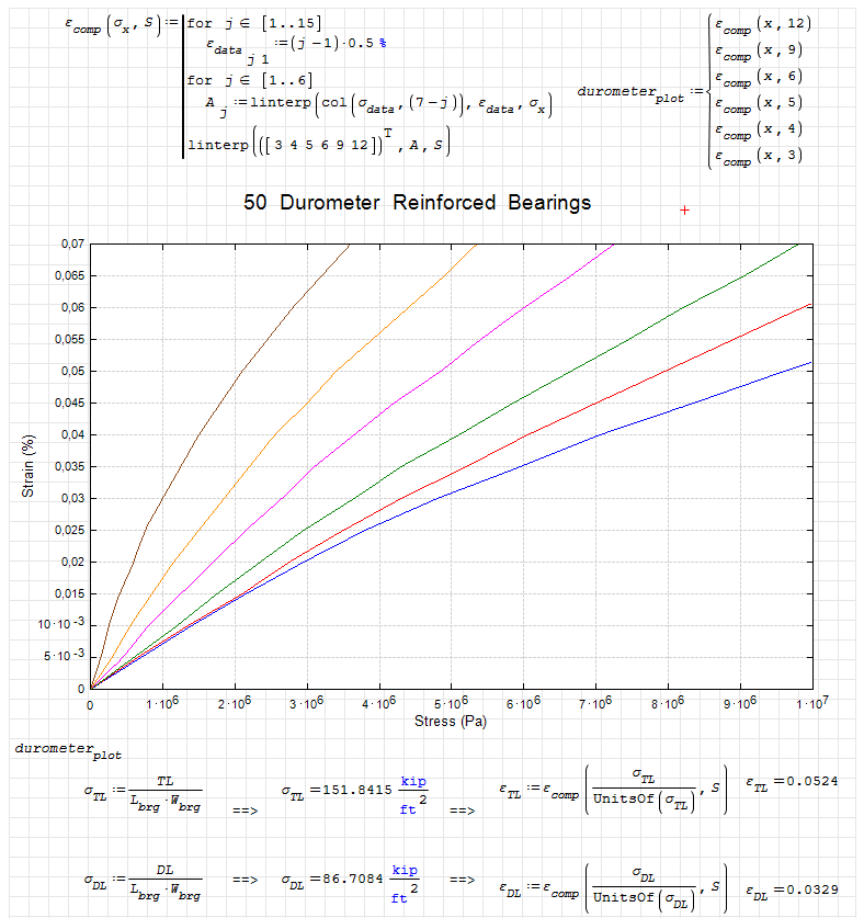

#4 Posted: 5/14/2020 1:26:05 PM
Thanks...I did not have X-Y Plot region addon. With it - I was able to get an output:
Does all that I need it to do. Only other option - see how MathCAD allows inverting access, or call Y-Axis range into equation. So I reversed position as X-Y Plot only seems to pull input from X-Axis. Is there a way to call Y-Axis?

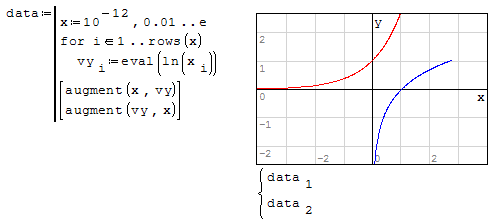

Tabulate discrete, inverse the collection ...

#9 Posted: 5/14/2020 6:31:12 PM
Like this. Implicit plot mode used.
USC EB EXP LFD (uni).sm (130.45 KiB) downloaded 1209 time(s).
