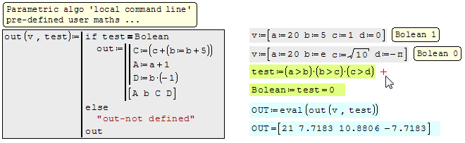

From the directed visit Samples, iterative is bidirectional.
Or multiple conditional Golden ratio
More advanced conditional is generally Bolean... Example attached.
Show something of your Creation.
Cheers ... Jean.

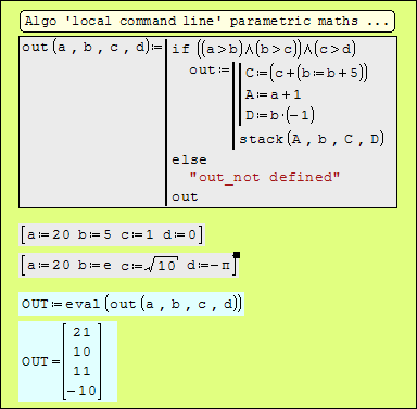

#8 Posted: 4/8/2023 2:08:03 PM
... adapt the out maths to your project.

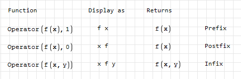

#14 Posted: 4/18/2023 7:23:00 AM
1,443 likes in 2,936 posts.
Hi Davide. Something like this other?
this maybe?
also, prefix/postfix functions can be made for unlimited arguments.
I've tried something like postfix(F,x,y) but it isn't really user-friendly (e.g. it can't be used on the LHS of an assignment because it overvrites the postfix() function itself)
