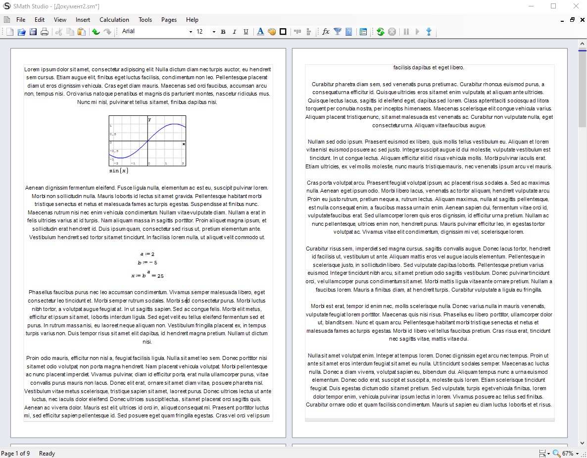

The main idea is that there are two modes of the documents should be supported by SMath Studio:
  1. Worksheet - equations has the first priority! - standard mode of the program;
  2. Document - text has the first priority! - new mode
Document mode is a mode when one is working with a file like in MS Word. This is a text processor with possibility to insert equations. The only difference is that these equations are automatically calculated!
What to expect:
  • There is no red cursor anymore;
  • Enter can be used to make line breaks (no need to press Ctrl or Shift to make it work);
  • Everything is vertically aligned by a baseline.

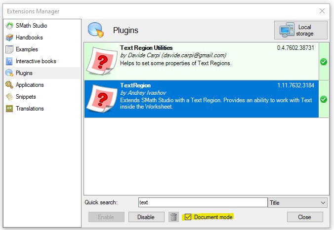

  1. Open Tools > Plugins..., find and select Text Region, set Document mode checkbox checked:

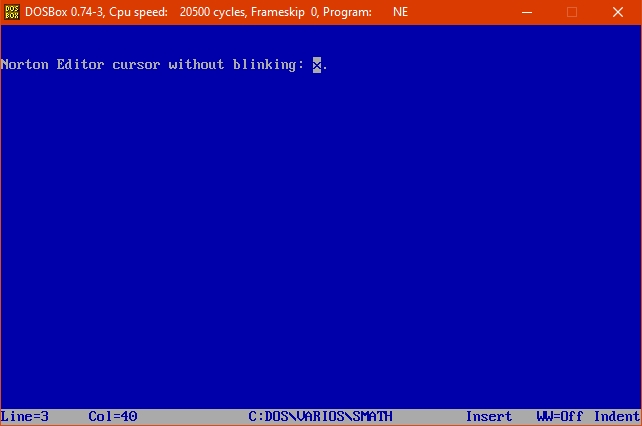

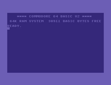

That's could be not an issue, but a feature. Just make it an square without blinking, like in Norton Editor! It's more peaceful write without a cursor continuously blinking in front of the user face.
You couldn't be any more right.
Nothing triggers me to write something more than a nonblinking cursor.
Probably I love retro more than I think.
Alvaro 11/26/2020 4:45:00 PM

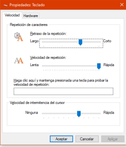

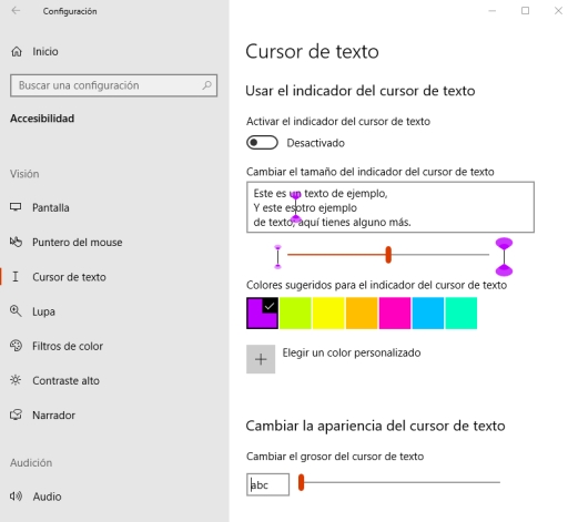

Blinking cursor makes easier for the brain to spot immediately the position (like when you have to spot the position of an animal in the wild). Solid cursor is nice but is a little bit odd with non monospaced fonts.
Ups. I'm not thinking about that. With proportional fonts it probably doesn't look as good, and a blinker free bar is harder to locate. Actually it's explained here, in french:

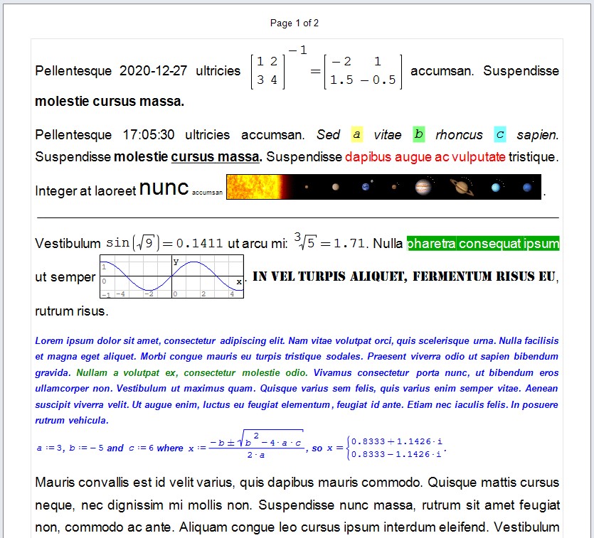

  • So, now it is possible to perform formatting of text fragments in Text Region, not only the whole content as it was before.
  • Another interesting feature is auto detection of equations (and horizontal rules) in the text: write 2+3 or anything else and program will automatically convert it to Math Region inside a text).
Of course all the features (except paragraphs in text) supported in Document and Worksheet modes of SMath Studio.
Currently I'm working to fix several issues in formatting capabilities, to allow creating links (anchors) for the text fragments and increase stability.
Some notes:
  • line interval and text alignment features currently available using context menu only;
  • Enter adds a paragraph, while Shift+Enter inserts a line break;
  • It is possible to copy formatted text or its part and paste to MS Word or any other program which supports HTML from clipboard;
  • Full back-compatibility for Worksheets created in previous versions of SMath Studio provided.

During last years I've implemented pretty good engine for rendering pages of the document/worksheet with support of high DPI, code (i.e. program) became cross-platform and it is now easy to extend plug-ins capabilities for better user experience. So I've decided why not to reuse this possibilities to create something new as it is easy to do and may be handy for at least some part of community? Another important reason is that anything I will do for this new Document mode will improve legacy mode as well. Taking in account many requests from users to add formatting capabilities to Text Region and my old idea to make something like MS Word for calculations it became obvious that work must be started.
Even after all improvements I did TextRegion plug-in size on a disk is just about 70Kb. It is fully cross-platform (uses SMath.Drawing namespace). It does not require any third-party library so no hell with licenses and I can deliver everything full-functional and free.
And I'm not talking only about built-in functionality... SMath Studio already allows to select another plug-in as a handler for text in Document mode, so functionality there can also be modified and improved by community. Hope Writer Region Plug-in will be updated soon to be reused there.
