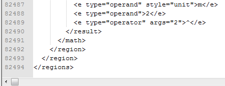

Hi all,
Trying to reopen a file that I wrote and that refused to be closed normaly, I receive this message:
"Unexpected end of file occured.
The following elements are not closed:
result, math, region, regions. Line 82490, position 12."
I posted the file here:
file
Is it possible to recover the file ? If yes, how ?
Thanks a lot for any help,
Ioan

The problem might be solved by just closing the xml tags in the file, but I can't try...
The solution is indicated by mkraska and the result is in the attached file

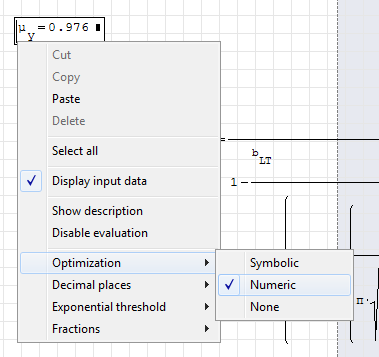

I still have a problem with this file:
all results are in fractional mode, against my temptatives of changing.
#6 Posted: 7/3/2012 7:18:06 AM
1,443 likes in 2,936 posts.
You are welcome
simply change the result optimization from "none" to "numeric"
regards,
w3b5urf3r
