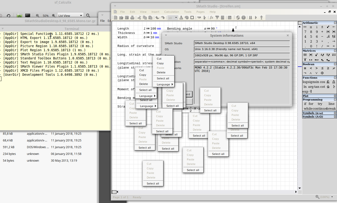

#8 Posted: 1/11/2018 8:14:34 PM
1,361 likes in 2,275 posts.
SMath Studio: SMath Studio Desktop 0.98.6585.18710, x64
OS: Unix 3.16.0.38 (friendly name not found, x64)
Screen: 1662x928 px, 96x96 dpi, 96 GP.DPI, 1 GP.SRF
Localization: separator=; decimal symbol=; system decimal symbol=; language=ENG
Frameworks: MONO 4.2.2 (Stable 4.2.2.30/996df3c Mon Feb 15 17:30:30 UTC 2016)
Mint 17.2 on a Virtual box.
I get a strange error: The context menu doesn't close and stick in the foreground. This is triggered by trying to zoom the canvas by ctrl-drag middle mouse button (Lenovo thinkpad trackpoint). The menu windows don't vanish when the program is closed. They only vanish if the temporary terminal window is closed as well.
There is no way to zoom the canvas with trackpoint or trackpad. I have to use the status bar zoom menu for zooming.
Under Windows I can use two-finger guestures on the trackpad to zoom.
This may be due to insufficient hardware support in the linux box.
BTW 6580 crashed when I started typing to the canvas. This problem is solved now even though my mono might not be up to date.
2018-01-11 23_59_09-Mint_Mate_Mech_2015_10_30 [wird ausgefuhrt] - Oracle VM VirtualBox.png
Andrey Ivashov 1/12/2018 12:46:00 AM

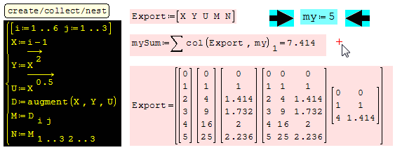

#18 Posted: 1/17/2018 2:52:46 PM
Really nice!
Yes Martin: very nice !
Now, you committed yourself for more testing, is it .
The very best example is the Mandelbrot set.
If we delete the last line of the complete program,
we can see the nested collection that the final Mij explodes in matrix.
The very original Mathcad [6, 7 ?] was lot more complicated because it
didn't have the Mij LHS Exploder.
Maths Vectorize COMPANION [CreateCollectNestSum].sm (116.55 KiB) downloaded 1431 time(s).
