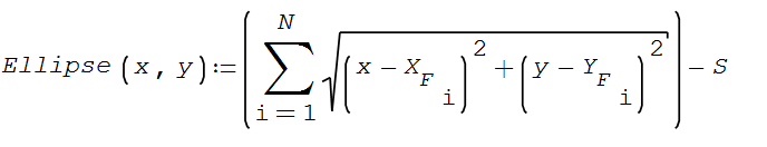

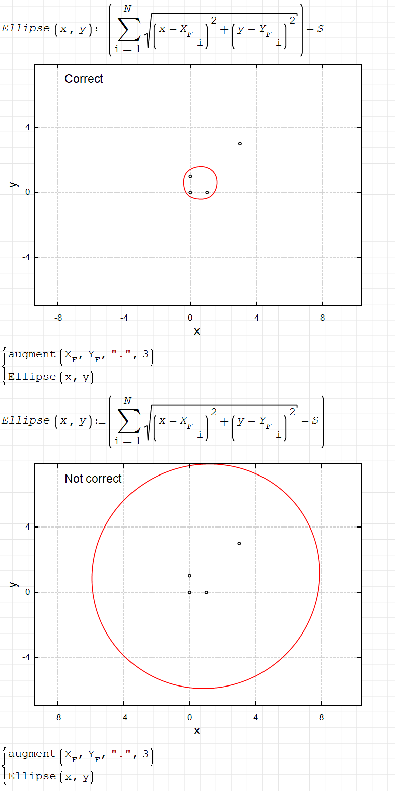

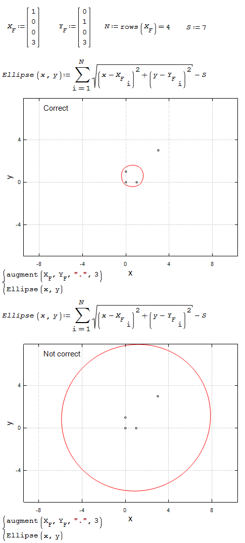

My students were building a multifocal ellipse and... almost went crazy. My ellipse is correct, but the student's is incorrect. Although the formulas are the same.
Can you guess where the error is and whether it is necessary to modify SMath so that such an error is visible?

In fact only apparently the written formula is the same but in the first case "S" is outside the summation while in the second case it is inside the summation. You can verify this by copying and pasting the two formulas into a text editor.

Further illustrated by adding parenthesis around the summation in each formula

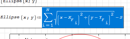

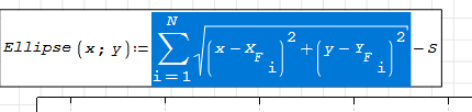

Show Spoiler
You can also select/double-click the sum symbol to check what belongs to it.

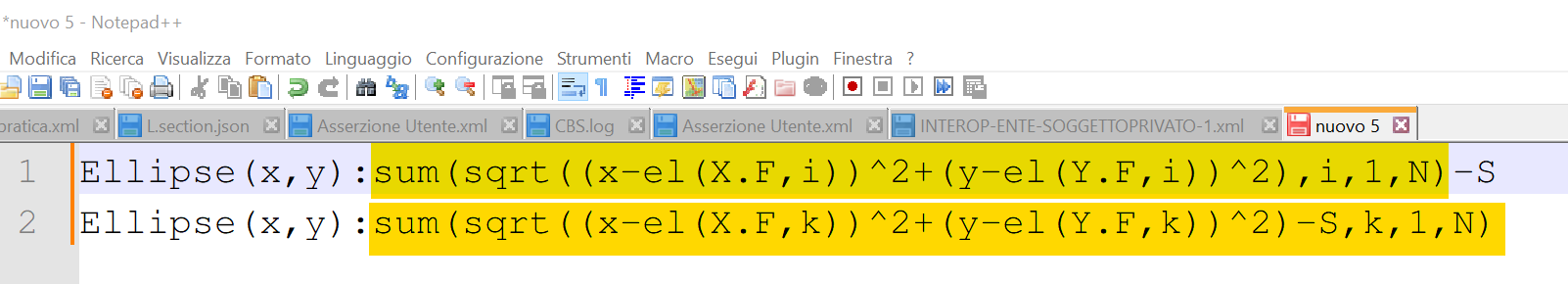

The problem is that in the first Ellipse(x,y) definition, variable S is outside Sum function, but in the definition of your students is inside:
Your definition:
Ellipse(x,y):sum(sqrt((x-el(X.F,i))^2+(y-el(Y.F,i))^2),i,1,N)-S
Student´s definition:
Ellipse(x,y):sum(sqrt((x-el(X.F,i))^2+(y-el(Y.F,i))^2)-S,i,1,N)
Maybe, this explicit form is most clear for students:

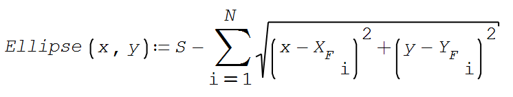

#6 Posted: 9/7/2023 1:43:13 PM
Valery Ochkov
Valery Ochkov
66 likes in 700 posts.
Better so

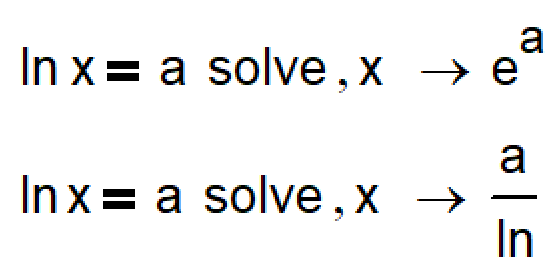

It if Mathcad 15
1 ln(x)
2 ln*x - why not
