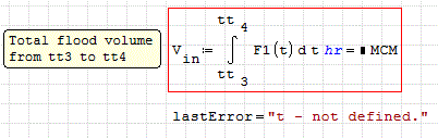

#5 Posted: 4/8/2016 8:21:25 AM
600 likes in 1,381 posts.
integral isn't calculated in this example. Culprit is maxima plugin. If it is installed you can't get a result.

#7 Posted: 4/8/2016 2:48:36 PM
Integral works for me:
You are totalising an hourly rate of accumulation
over the [a,b] time limits for a total MCM [m^3]
