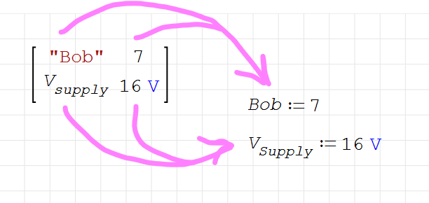

WroteIs there a function or method that would allow a string (or variable name) located in a matrix element to be used as the name to define a variable?

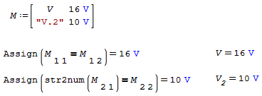

You can also use the Assign() function of the Maxima Plugin (this should work even without Maxima installed).
It converts boolean equations into assignments.
In the case of strings you still need to apply str2num()
Assign.sm (4.75 KiB) downloaded 1334 time(s).

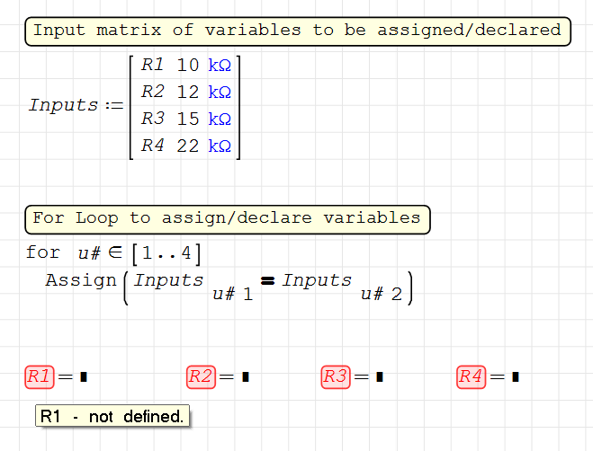

Any thoughts?

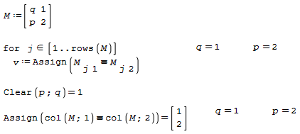

I'm hoping to be able to assign multiple variables from a matrix like this:
Assign For Loop Broken.sm (5.11 KiB) downloaded 1263 time(s).
I think the assign command is not evaluated immediately, but has a delayed evaluation, which somehow only takes place after using the "=" symbol.

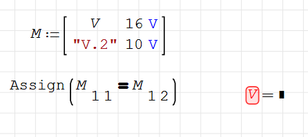

WroteSome odd behavior here. When the "=" evaluation is removed the Assign() function breaks:
Assign odd behaviour.sm (3.14 KiB) downloaded 1311 time(s).
Any thoughts?
Two hints:
- The Assign function needs to be executed in order to do it's work, either by assigning the result to some dummy variable or by requesting display of the result.
- You don't need a loop, Assign() can handle vector arguments

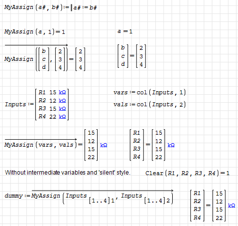

MyAssign 2.sm (10.52 KiB) downloaded 1333 time(s).
I have a folder on my computer exclusively for the spreadsheets you share.

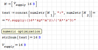

https://en.smath.com/forum/yaf_postst23228_Assign-Description-to-Variable.aspx
It's a work around, but potentially useful.
