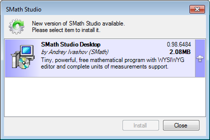

Simple question: now when I start Smath from the task bar Win. 7
that's what I get on the fresh work sheet
I presume, click on the cloud to install, will install the new version over 6179,
that means just patch for whatever codes that are new or refactored ?
Objectively all should be transparent.
Am I right/wrong ... don't want to damage 6179 !!!
Thanks, Jean

1,361 likes in 2,275 posts.
Perhaps you run the installer version of SMath 6179 (not the portable version).
In this case, your installation is updated (you may also need to update some plugins).
To try the new version without harming your existing one, use the portable version (see my signature for a link) as a sandbox.
You simply unzip the archive anywhere and run the SMath exe in the new directory.
If you like this version, you can declare it as default application for .sm file using context menu in the file manager (Open with...).
Oscar Campo 10/3/2017 6:44:00 PM

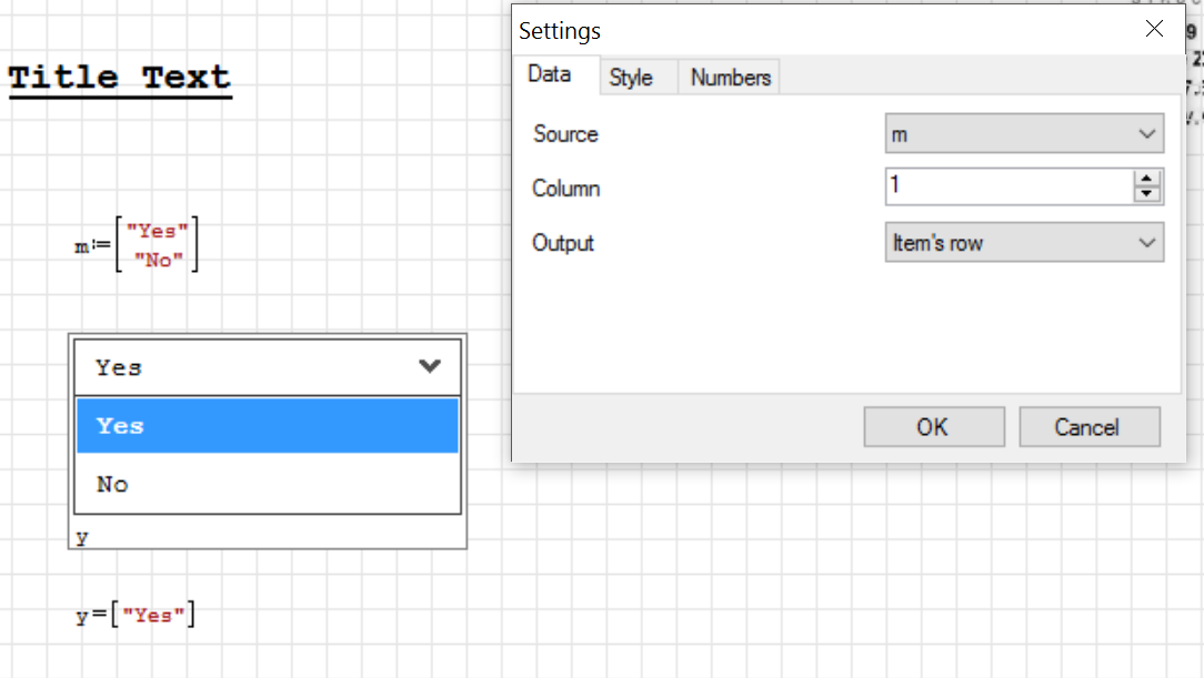

I have found two issues (at least an issue for me):
1. ComboBoxRegion puts the assigned variable (aka the result) into a matrix. Other functions which use this variable then throw an error because you are trying to use a vector as opposed to a scalar.
I'm not able to reproduce this, works fine for me.

Regarding the combobox... I'm sorry, I misspoke.
I meant to reference the ComboBoxList (insert -> controls -> ComboBoxList). There must have been a change when using "Output = item's row". When I had used a column vector it would return the output as scalar. Not it returns it as in a matrix. This actually makes sense. I should change my sheets that that "Output = n-th element in the row", this would give me a scalar result.

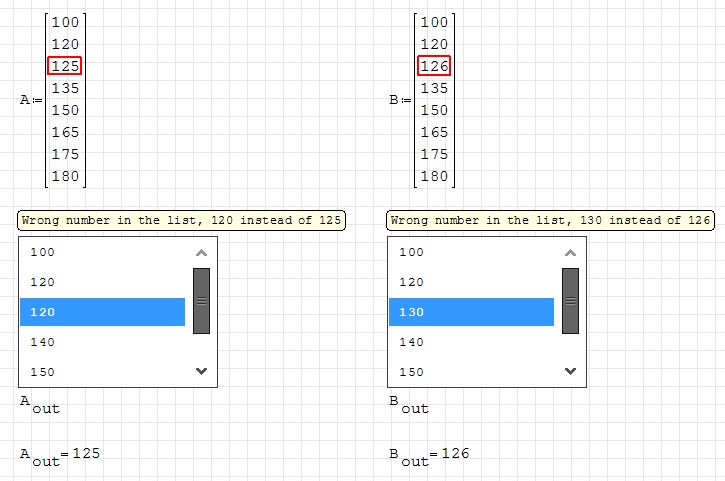

I found an issue in the ComboBoxList plugin. I updated Smath and plugins to new version (0.98 build:6484), and noticed that the values in the listbox don't match with the input values (I think in the previous version all was fine):
Here is a sample file:
ComboBoxList issue.sm (4.99 KiB) downloaded 1750 time(s).

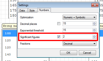

Could that be due to the number format setting? Seems that just two significant figures are displayed.
However, if I open your sm file, the numbers are displayed correctly.
It is due to that; numbers are rounded to 2 significant digits, as set in the options of both the regions. Set it to 0 to not have this behavior.
If you mean that you can read "126". that's strange; I'll look if might be some localization issue.
