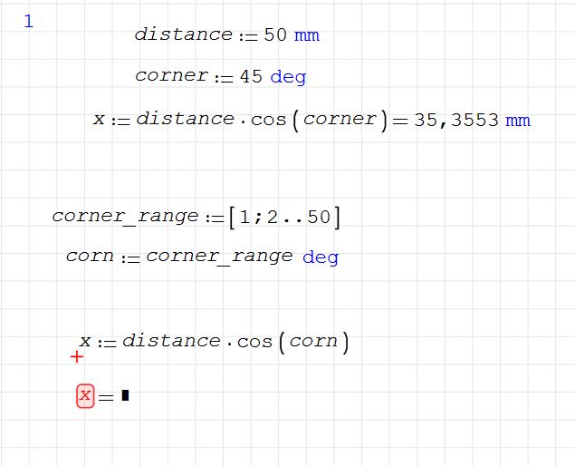

Dear
I have problem with rank along with unit.
Par example: x = 50mm * cos (30 deg) = 35,35mm
But when I use range corner = 0,1,2...50
x = 50mm * cos(corner) don' work!
I try with vector, but it don't work.....
Thanks

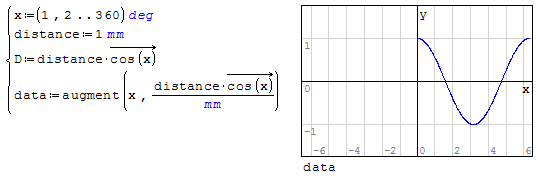

#2 Posted: 8/5/2021 4:33:03 AM
127 likes in 342 posts.
in fact, the solution has already been given to you.
cornerRange.sm (6.1 KiB) downloaded 1259 time(s).

Dear
Thanks
If you pay attention to the others solutions, you missed the VECTORIZE function
