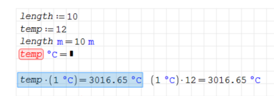

An image to describe the problem:

I can confirm. In addition, parenthesis and isolating the unit causes an error
Oscar Campo 9/17/2021 12:25:00 PM, sergio 9/17/2021 12:36:00 PM

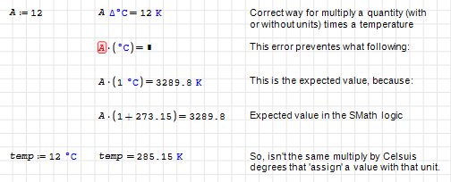

Hi. I'm not sure if that error is a bug or a feature. Because it prevent an unusual task: using degrees scale temperature (those that have an offset) in a multiplication, where the usual is using the "new" Delta scale temperatures. I take my time to understand why it's neccesary to use Delta's, but get convinced after some good Martin's explanations (here).
This image shows why I think that:
Oscar Campo 9/17/2021 3:56:00 PM, sergio 9/17/2021 4:15:00 PM

I agree with Alvaro. The result is actually correct. I do believe it's still a bug, however, as you can add/subtract degC with seemingly strange, but correct, results.
