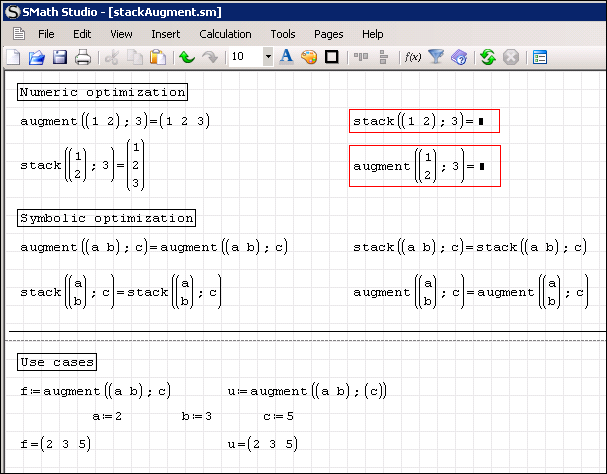

I've checked what could be done with stack/augment to fix issues you are mentioned and I've made corrections to your approach: symbolic engine will not either evaluate augment/stack functions or raise an exception if dimensions of the arguments don't match. It will pass these functions to allow numeric engine make a final decision about what is error and what is not.
Please see Use case section of the screenshot below for understanding the reasons.
Davide Carpi 6/17/2012 6:25:00 AM, Radovan Omorjan 6/17/2012 7:35:00 AM
