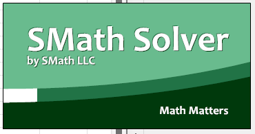

When I went to open SMATH a couple of days ago, the program notified me that there was a new version of SMATH and prompted me to install it. I did so, and SMATH will no longer open. I have tried several things to get the program to open including uninstalling and reinstalling the software from the website, but no luck. The loading bar that moves along a curved medium green stripe during the startup of the program always pauses and then aborts the program (as shown in the picture).
I am running Windows 10. Is anyone else having this issue? Thanks in advance!

There are several plugins that prevent an old v0.99 version of SMath from opening, it is also possible that some Plugins are preventing your new version from opening as well; In the interest of debugging, did you remove/disable all of your currently installed plugins?
When you say that it will not open; does the startup SMath Loading screen popup and just close, or do you have no response/reaction when launching the application?

The initial screen pops up and the white bar begins moving along the medium green stripe, but then pauses and aborts the program. I am not sure how to disable any plugins for SMATH outside of the program itself (i.e. how should I try that without opening the program?). I don't think I have additional plugins installed, but I figured uninstalling the program and then reinstalling it would fix any potential issues involving plugins though. Any further thoughts would be appreciated. Thanks for such a quick response!
