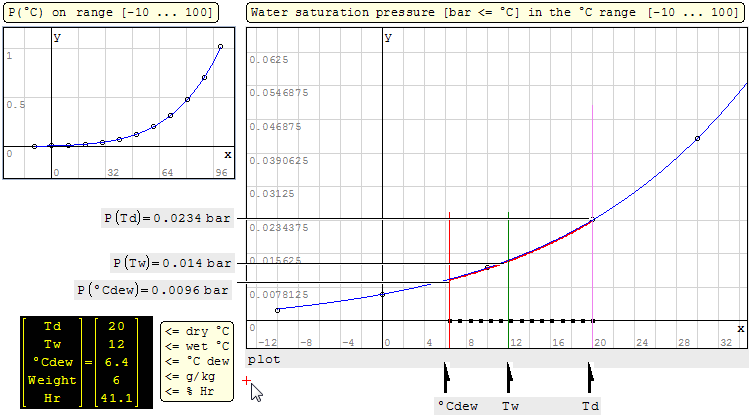

#1 Posted: 4/9/2018 9:49:03 PM
... refreshed for publishing.
Inst_Psychrometry [Weather Station].sm (221.12 KiB) downloaded 1090 time(s).
#2 Posted: 4/10/2018 12:04:11 PM
Ruben Sidranski
Ruben Sidranski
17 likes in 465 posts.
Your index on the polynomial sum is off. It needs to be j-2, not j-1
Edit,
I looked at ASHRAE 2017 SI edition. Your polynomial does not compute. Not sure I can post the sheet, I'll be happy to send it to you if you PM your e-mail
#3 Posted: 4/10/2018 2:48:02 PM
Your index on the polynomial sum is off.It needs to be j-2, not j-1
Edit,
I looked at ASHRAE 2017 SI edition.Your polynomial does not compute.Not sure I can post the sheet, I'll be happy to send it to you if you PM your e-mail
My polynomial is correct, sanity checked vs WASP.
Either your system is kaput or the Smath version you use is kaput.
Let more Doctors verdict if your latest Smath is kaput.
