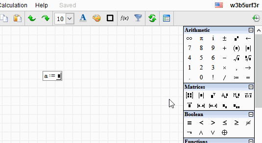

If I type
a:
then press the matrix toolbutton, then insert on the row.cols dialog.
Nothing is inserted.
The insertion marker is the reverse-L
If I click on the square to get the normal-L, then it works.
The problem is what Davide shows below.
It is only on Cloud version.

#5 Posted: 3/30/2018 12:38:39 PM
1,443 likes in 2,936 posts.
Seems not always reproduible ... tomorrow I was able to reproduce immediatly, now only every once in a while (Firefox 59.0.2)

It is exactly as Davide shows above.
Problem the same with browsers: Opera on Linux, Edge on Win10, Chrome on Win10
