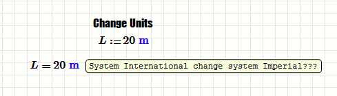

Hello, my dears, can you help me with a problem I have with the units in Smath, how can I change units from one system to another? Apparently the Smath works by default with the International system, if you wanted to only work with the metric or imperial system where would you configure???????

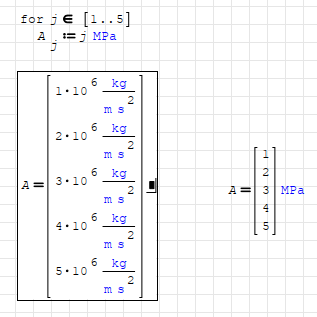

2: Another concern I have is how to change the units in an already defined matrix

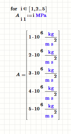

#3 Posted: 10/23/2023 12:36:13 AM
If you want to preserve MPa ... in the A result,
in the for loop multiply i*silent MPa
Silent is 'MPa

1 - There is no permanent SI/Imperial option.
You can easily input imperial units to variables.
Yet SMath works with SI Units under the hood.
Even if you input variables in imperial, results will be in SI.
However, results can be shown in imperial too.
Just click to result, a placeholder will appear.
Input your desired unit at there.
Unfortunately you have to manually alter every result.
2 - You can't change individual units of result matrix as explained above.
Yet you can input a unit to placeholder of result matrix.
If every element have same units, it will be beautiful.
If not, it will be a mess. Try to learn table region plugin for that purpose.

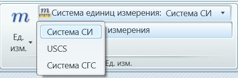

There is the option to switch the output system from Metric to Imperial; but that feature is half-baked: Don't use it; would be more productive for you to just manually override a given equation to the units you want to see.
