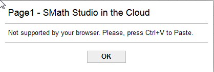

If I try to paste an image from the clipboard to the canvas in SMath in the cloud, then I get an error message:
What browser is supposed to support image pasting? I use firefox 57.0.4
Using Ctrl-V does nothing, the above error message results from using the paste entry in the canvas context menu.

Hello Martin.
Thank you for the report! I will check this issue within next two days.
For now you have two alternatives:
- drag'n'drop image into the worksheet;
- use Insert > Picture - From file...
Sorry for the inconvenience!
