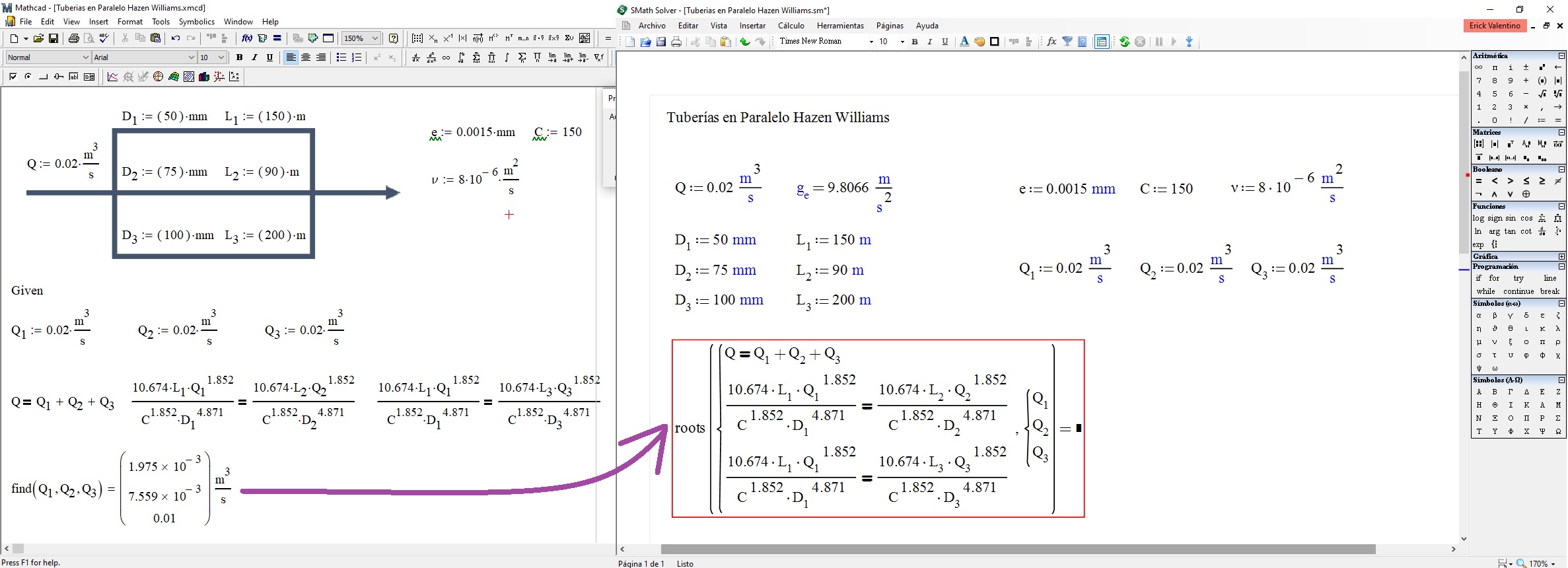

I would like to know how I can replace the "given" command from Mathcad to SmathStudio, I know that such a command does not exist in SMATH and for that there are other tools
I just need to find the flows Q1 Q2 and Q3 from a parallel pipe using the Hazen Williams equation, without having to do as many expressions
Thank you very much

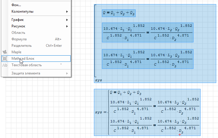

QuoteI would like to know how I can replace the "given" command from Mathcad to SmathStudio, I know that such a command does not exist in SMATH and for that there are other tools
You can use Mathcad Block region for this.

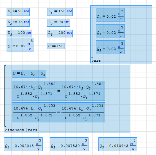

You can use FindRoots() for that purpose.
Regards.
tuberias.sm (11.75 KiB) downloaded 1280 time(s).
WroteOr like this.
What the..? I didn't know you can use mathblock like this.
How FindRoot() can work under block with only one argument?
That is a very neat feature. Really appreciate you share this.

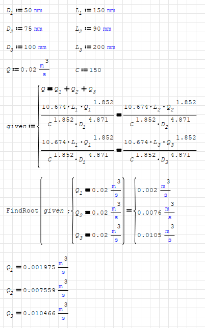

WroteI would like to know how I can replace the "given" command from Mathcad to SmathStudio, I know that such a command does not exist in SMATH and for that there are other tools
Given/Find/Maximize/Minimize/Minerr/ODEsolve
1. Given/Find ... inspect Butler attached
2. Given/Minerr ... from iterative Smath code
In many instances superior to Minerr.
Given/ODEsolve from very many Smath ODE solvers.
Visit the code from Viacheslav [Uni]
Solve Given_Find [CO2_6179 Butler] Copy.sm (165.95 KiB) downloaded 1047 time(s).
WroteThe first argument is implicitly substituted by the block itself. Then the function is called with two arguments.
Does mathcadblock could be used with al_nleqsolve() with this example?
And I think it would be nice if block can be inserted with command.
Not just from Insert menu, regards.
