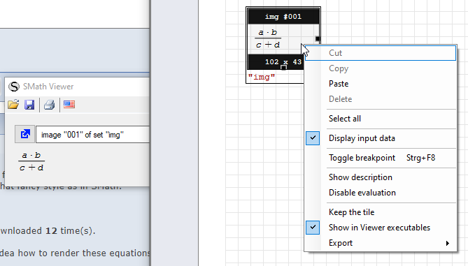

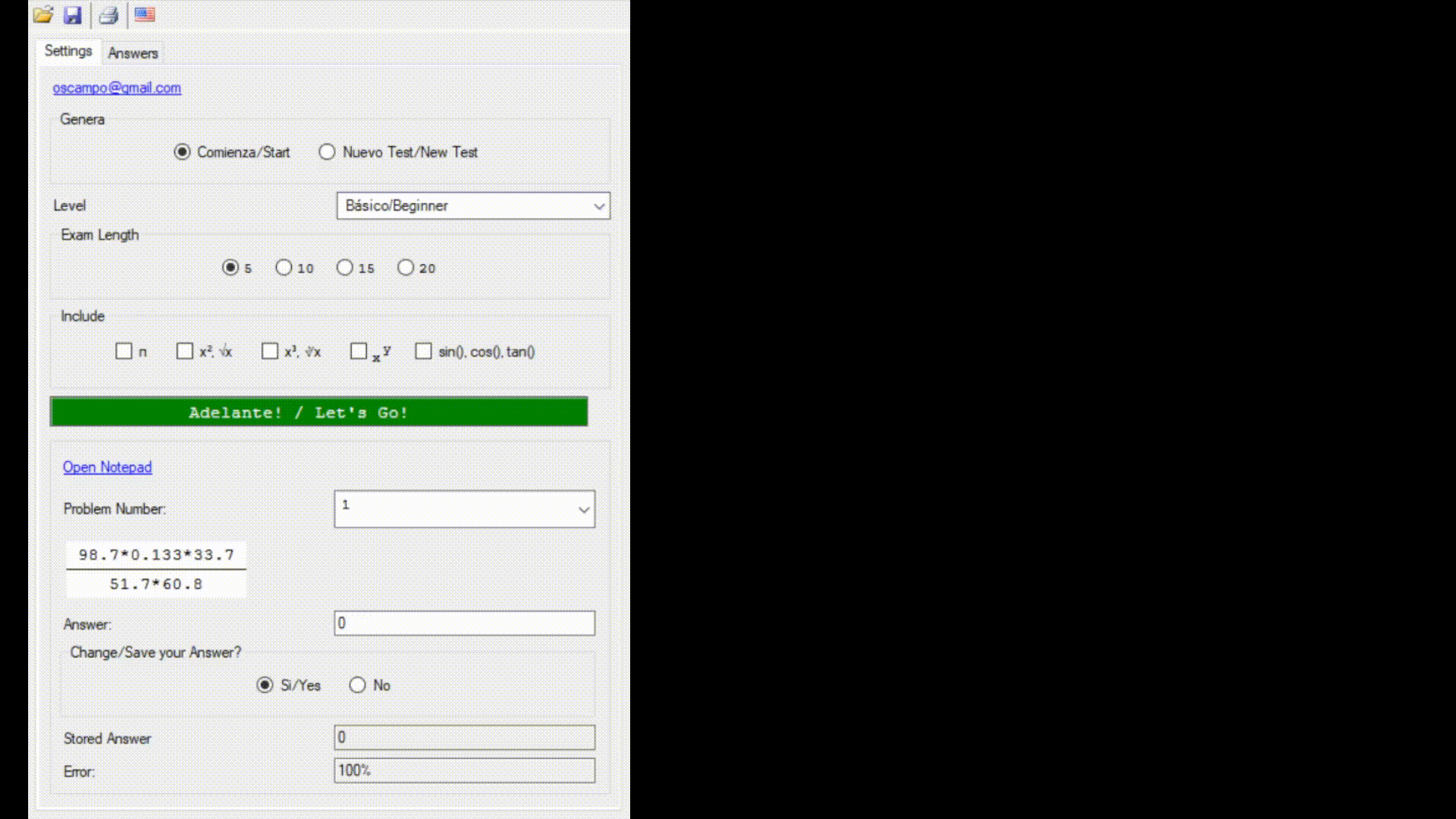

I'm working on a simple app for training on Slide Rule use (for my personal purposes), and I can generate problems for practicing that involves multiply, division, pi, x^2, sqrt(x), and so on. But when I run the generated app, the equations are not shown in that fancy style as in SMath.
Please take a Look:
So, maybe anybody has an idea how to render these equations in the viewer?

You can use a snapshot region, but it has decorations in the viewer which you might not want.

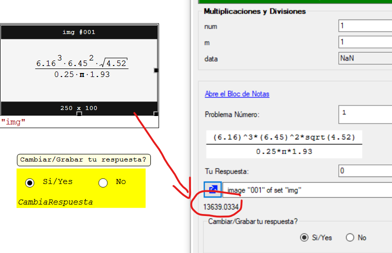

Thanks for the suggestion, but this technique evaluates any operation/number included in the equation, and I have equations with numbers that I don't need to be evaluated.

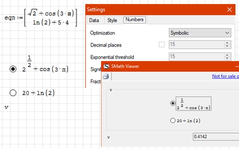

Hola Oscar. It is not The solution, but maybe a half of it: the radio button list accept "Symbolic" as an option for view (but not "None", which I guess that it is what you need). BTW maybe some expressions could be showed as you want.

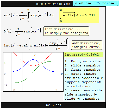

Similarly to X_Y plot, the background color of snapshot
is the active background color [any of 16777216 ... !]

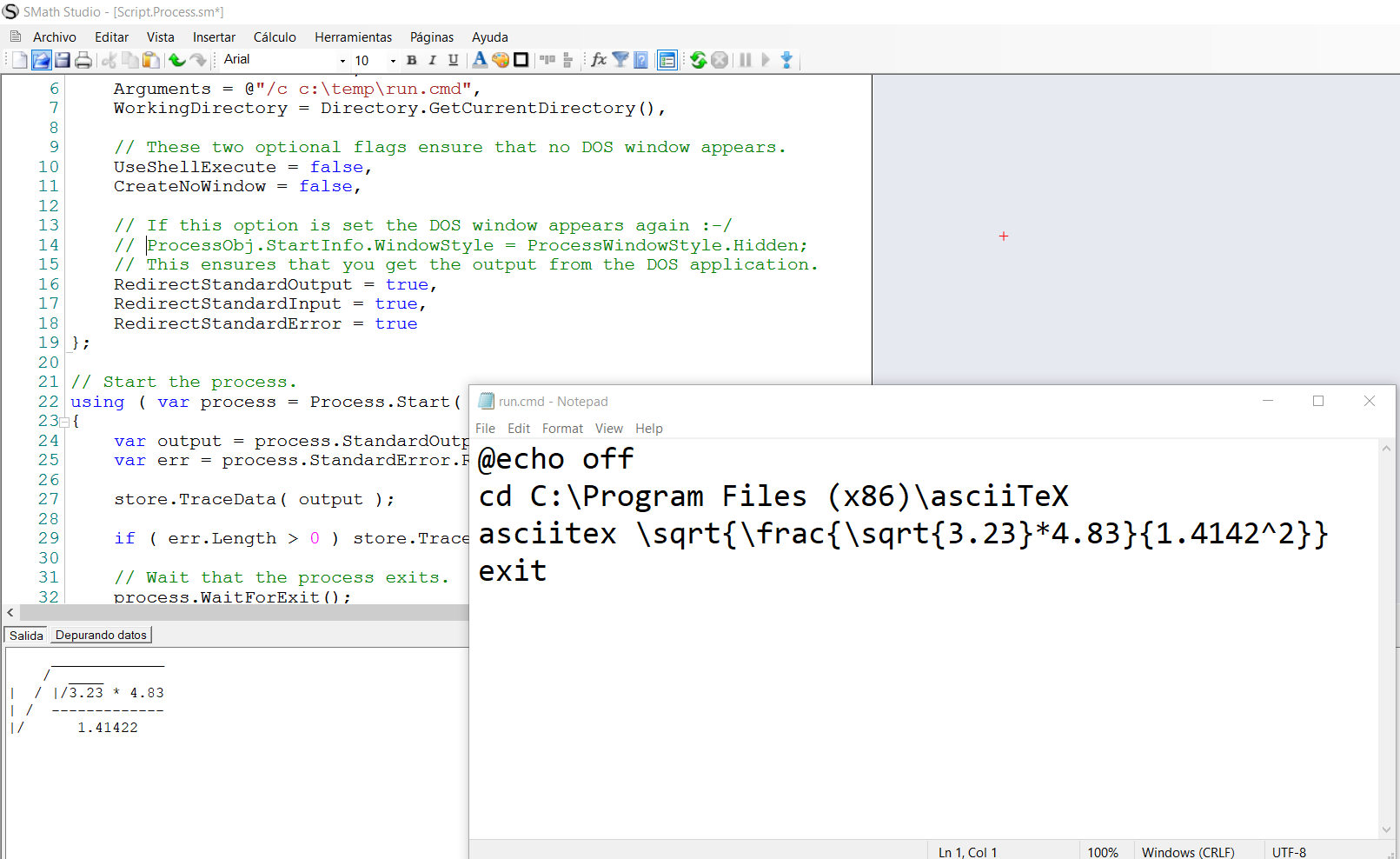

By the way, I'm trying a fancier solution, by using ScriptRegion and a DOS app to render equations to plain text, as you can view:
