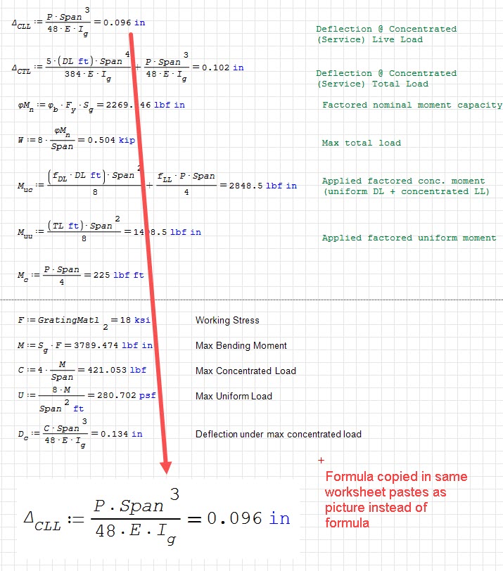

I'm having a problem now when I try to copy and paste formulas between worksheets where SMath Solver pastes a picture of the formula into the new worksheet instead of the formula itself. It's intermittent as I can paste a picture of the formula, and then after a few more tries, correctly paste the formula itself. Anyone else having that problem? This slows down creation of new calcs tremendously if I can't copy and paste sections of formulas and common text from other worksheets already completed (like reinventing the wheel each time...). Any help is appreciated!

Now, it's happening even in the same worksheet. See screenshot below demonstrating what it's doing. The preliminary calc file is also attached this time, since it's happening in the same file, which there was no point attaching earlier since it was happening intermittently between files. Bar Grating Calc.sm (266.64 KiB) downloaded 1406 time(s).

I'm selecting the region(s). Normally, if I write a bunch of formulas for the a-axis properties of a structural member, for instance, I'll select all those formulas and copy them down and change all the subscripts from "x" to "y" or "z" or whatever is appropriate for the next set of formulas in some calcs. This makes generating calcs much faster, and is the behavior I've observed in SMath for the last several years I've been using it. Now, it is still doing that sometimes and not other times. It hasn't been consistently one way or the other, so I don't think it's intended (I hope the pasting as a picture isn't an intended "feature"!). I think the inconsistent behavior would be considered a bug either way. This is with build 7921.

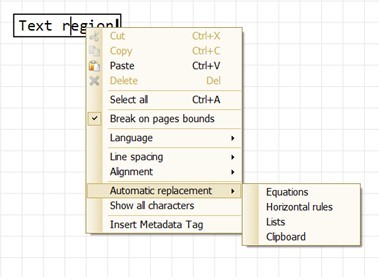

I never saw that behavior. The only SMath option that could be related to the problem, and that I know of, is the one shown in the image.
Perhaps changing some of those options will solve the problem.
Yes I have had problems sometimes with certain programs that interact with the windows clipboard. Even Microsoft Office has options to keep a history of the clipboard, and there are other programs with similar or more advanced features.

Alvaro: what is that "Automatic replacement" option that you showed on the text region context menu? I didn't even know that was there, and when I search for it, I just see it listed as an item in the recent version history, but no explanation of what it does.

Hi. Yes, it is a new feature. Disabling it prevents clipboard content from being pasted into a text region like math. I have it disabled, but I think the default option is to have it enabled.
I have no idea if those options could be the cause of your problem, but hey, in the end they are options about the behavior of the clipboard in SMath.
