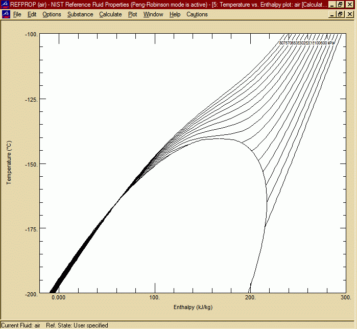

There are not "not yet implementing" or bug in CoolProp. If can't work in this region is because is very difficult to solve the inversion: For each enthalpy there are two valid temperatures in the phase line. Which make unstables (when not imposible) some algorithms. For this case the system can't be determined with the usual two intensive or extensive properties states, and need 3 or, inside the region, one intensive an the quality. See the attached diagram.
Or here, the diagrams for PR in mathcad: https://www.ptcusercommunity.com/message/424574#424574

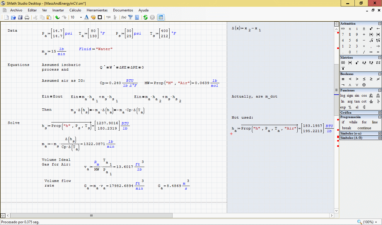

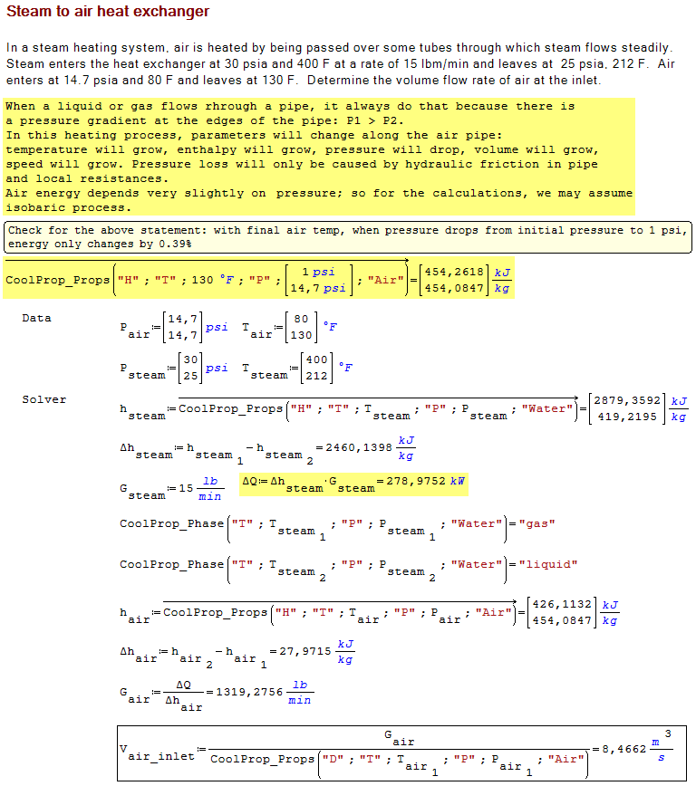

MassAndEnergyInCV_Mike.sm (20.83 KiB) downloaded 1497 time(s).
Edit: I see that the air flows outside the tubes; however, the said holds true: the pressure drop across the starting and ending points cause air flow; this pressure drop may be ignored for the task. The losses that are ignored here, constitute much higher indeterminacy.

Yes, thanks, that's correct. Can be obtained also with mixing models: IG for air, steam props for water.

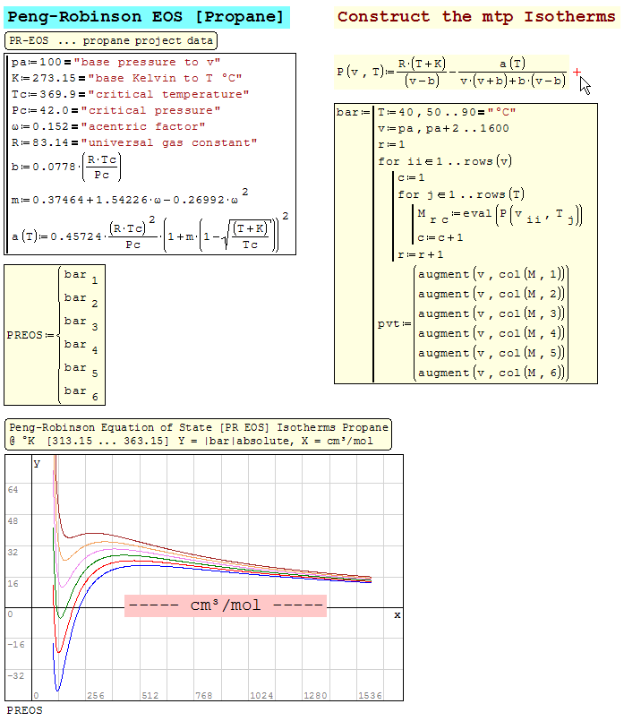

PR EOS.sm (44.14 KiB) downloaded 1493 time(s).

PR_work_Mike.sm (41 KiB) downloaded 1505 time(s).
Please notice that you had some errors, particularily in calculation of L.

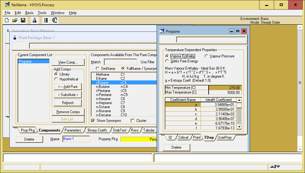

Hi Mike. For this is put images from RefProp about the ref states. Hysys use another method, and have H(T), gibss free energy and vapor pressure constants which uses in conjuntion with the PR EOS.
Attached, a table with some other values for critical values and Cp of ideal gas.
