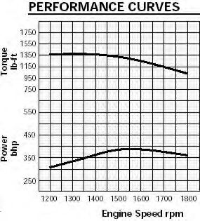

Image for the analysis:

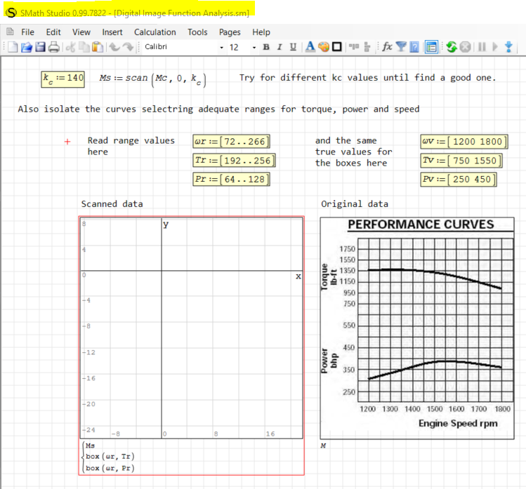

Yes, I have downloaded the image already.
It starts to give error on Ms:scan(Mc,k1,255)
`Argument doesn't meet to expected kind`.
Perhaps the image2rgb doesn't work under linux.
M matrix is filled with zeros, nothing else.

Hi. I remember now that the worksheet also use Mean, from statics plugin, and I put it definition at left margin, but disable. Maybe it's that one. This version have embed image matrix, and except for the XYPlot, I guess that it have not any other plugin.
I have statistical plugins with linux.
In windows, with same plugins and setting it solve.
And matrix is not full of zeros.
image2rgb is not working under linux.

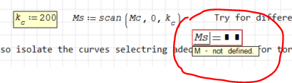

First, why the error in the SM file? I just downloaded and opened using Portable version on both Windows 10 and Linux.

Hi. You can try to eval only Ms outside the plot for read the error, if it is not an specific error related with the plot.
Ms is not defined. As you can see, I changed kc as well.

Nope. The message says that "M" is not defined, not Ms. And M is for load the image, not for doing some process. Try this version, with the image embeded in the worksheet:
https://en.smath.com/forum/yaf_postsm71146_Approximation-of-a-functional-curve-in-a-digital-image.aspx#post71146
and check if you can update the plugins for images.
I have tried the embedded image version with linux (not portable).
The image2rgb() doesn't work with image importing. But image data matrix embedded version works fine.
If image data added version don't work for you, Maybe the portable plugins are old and not suitable.

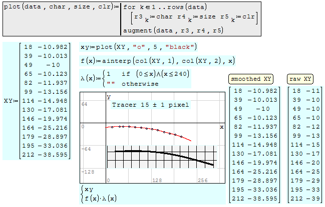

My other tool is via Tracer 15 [freeware]
Paste image as is in Tracer, capture at will pixels.
... once pixels in hand ► Ksmooth ► final fit.
