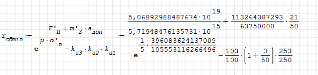

Hello. Tell me, please, is it possible to see the set numerical values when calculating formulas in the program? I mean, instead
of
a = 5, b = 6,
a + b = 11
see a = 5, b = 6,
a + b = 5 + 6 = 11

In the simplest case, this option would be suitable, but if the formula is a little more complicated, then we get a pile of fractions and numbers

#8 Posted: 3/30/2024 1:40:58 AM
TopUser2000
TopUser2000
0 likes in 28 posts.
Note: it has a little bit of a learning curve, but is worth considering never-the-less.
I don't see the result in the attached screenshots of how it works. A jumble of formulas where there is no clear answer.
