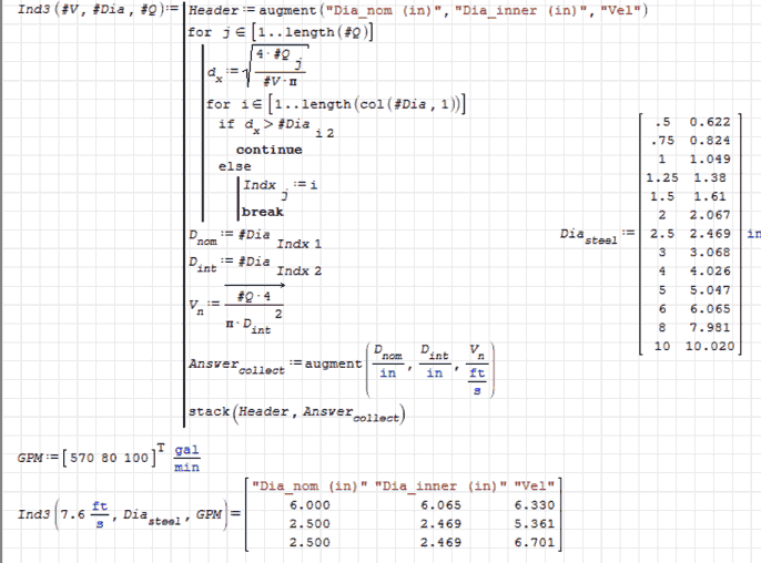

I need the information for 1 pipe diameter smaller ... sigh, I hate programming
PipeVel.sm (10.74 KiB) downloaded 1148 time(s).

#4 Posted: 4/13/2018 4:45:34 PM
CBG
CBG
78 likes in 312 posts.
Here is a solution
PipeVel_CBG.sm (8.94 KiB) downloaded 1223 time(s).

#5 Posted: 4/13/2018 5:18:30 PM
Ruben Sidranski
Ruben Sidranski
17 likes in 465 posts.
Muchas gracias Carlos. Lo que no podia ver es la indice else --> index.j:1 Handaba pensando en algo similar para retener el numro viejo, pero nada se me vino a la mente.

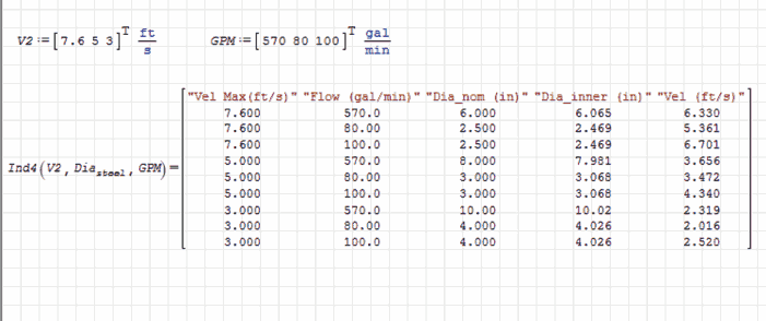

Ruben: A slightly more complicated algorithm, which supports several speeds and several flows.
PipeVel_CBG_R1.sm (14.85 KiB) downloaded 1241 time(s).

#8 Posted: 4/14/2018 10:07:09 AM
Ruben Sidranski
Ruben Sidranski
Interesting. I was looking at modifying your other code ... this is better inspiration.
I'm looking at sizing pipe at low flow, then calculate velocity, fixed pipe dia, at a higher flow. With your original code, I set this up in two steps to look at VFD driven system.
