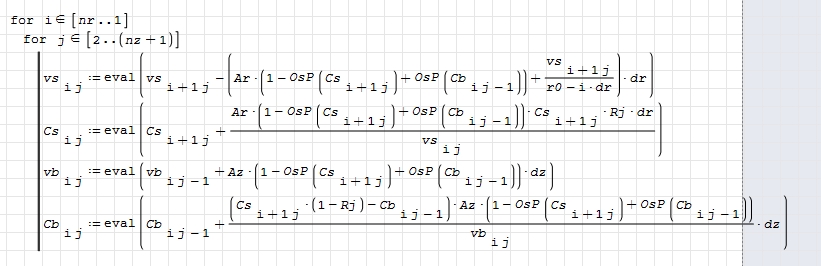

Hi. Two issues. First, you use two percent symbols, but forgot to put them as units: try to add them as '%, and they goes in blue color.
For the second, your observation now it's correct:
I suspect the variables stored the expression instead of results, which could take too much memory?
and can speed up a little the calculation using eval for each line:

Thanks a lot. It appears, eval is a very important function. I tried to eval every dimensionless variables and functions, such as OsP, dr before the loop. And it took some time finished the calculation. Still, takes ages long comparing to mathcad.
I hope the developer can improve this part soon. After all, the calculation load in my program is not heavy. I am really afraid if I introduce some iterations.

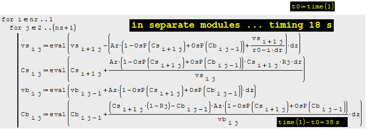

In separate mode my 1.66 GHz Win 7 calculates the 4 matrices in 18 seconds.

Leave them in separate modules, then collapse, it might reduce timing by ½.

1. Separate modules in the attached... Two complain, but produce.
2. Try matrix operator matrix(3,4) to see if it can help you wrt the project.
3. I know no other way to construct your 4 matrices.
4. From the matrices, your can select any col/row
... you can sub-range any part ... you can unwrap in single vector.
Cheers ... Jean.
