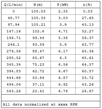

However, what I would like to do is something like this below:
I would like to show a variable value in place of "xxxx" in the caption of the above table.
I have not found any way to do that and probably it is not possible, for the actual version of this plug-in.
Any suggestion welcome.
Thanks
Marco

#4 Posted: 1/29/2020 12:22:10 PM
WroteI would like to show a variable value in place of "xxxx" in the caption of the above table.
... as live variable probably not possible.
If you say and tabulate the calculated values are normalized
at some speed xxx RPM then write it as such
All data normalized @ 3600 RPM

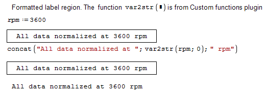

#5 Posted: 1/29/2020 2:00:52 PM
You could just place a formatted label region over the caption . This is a bit weird but it works. Use the context menu to switch off input and border.
label.sm (4.57 KiB) downloaded 1263 time(s).
In newer SMath versions, you can also use a standard text region with an embedded formula, where you can suppress input display and even specify a unit.
