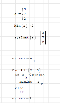

#2 Posted: 3/2/2020 5:53:18 AM
The "Min" and "Max" functions are used with the "Custom Function" Plugin.
Please note that the "sys2mat" functions are provided in the same plugin to transform systems into matrices.
If you don't want to use plugins, you can still as shown in the example
unfortunately "system" is not read by the "lenght" function so it is not possible (without the use of plugins) to create a function to automate the search for the minimum independent of the length of the system

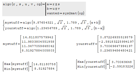

#3 Posted: 3/2/2020 8:17:08 AM
#4 Posted: 3/2/2020 8:45:34 AM
Utilities Algo(r,s,u,v,op).sm (6.84 KiB) downloaded 1379 time(s).
